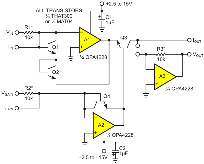

The squaring amplifier that is fast, temperature-compensated, calibration-free, and accurate (if the transistors are well matched)

Figure 1. The squaring amplifier that is fast, temperature-compensated, calibration-free, and accurate (if the transistors are well matched)
