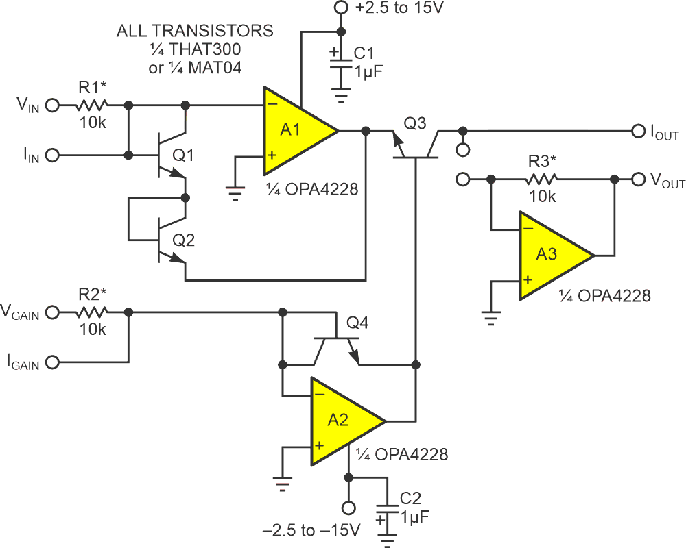

A classic nonlinear analog function is the squaring circuit. It’s useful in power sensing, frequency multiplication, RMS computation, and many other odd jobs around the lab bench.
The squaring amplifier that is fast, temperature-compensated, calibration-free, and accurate (if the transistors are well matched).
Figure 1. The squaring amplifier that is fast, temperature-compensated, calibration-free, and accurate
The version in Figure 1 is straightforward, fast, temperature-compensated, calibration-free, and if the transistors are well matched, accurate. The final output is as follows:
Its input can accept either voltage or current. It gains a bit of extra versatility from a separate gain factor control input, which can also accept voltage or current. Another boost in versatility comes from a similarly flexible output with both voltage and (inverted) current output mode. If the current mode is chosen, A3 and R3 can be omitted and a dual op-amp (OPA2228) used instead of the quad (OPA4228) illustrated.
The series connection of Q1 and Q2 generates a signal proportional to
This is applied to antilogger Q3 ,which subtracts
from it to generate a current of:
This is inverted and scaled by R3 and A3 to yield the final:
Note that if the three resistors are equal and VIN = VGAIN, then:
And, the squarer circuit will have unity gain.
