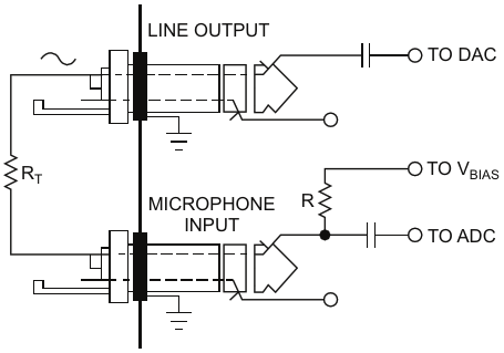

The internal microphone bias resistor and the externally connected thermistor form a voltage divider

Figure 1. The internal microphone bias resistor and the externally connected thermistor form a voltage divider
Figure 2. You can add second and third thermistors to your system by adding an external resistor divider
