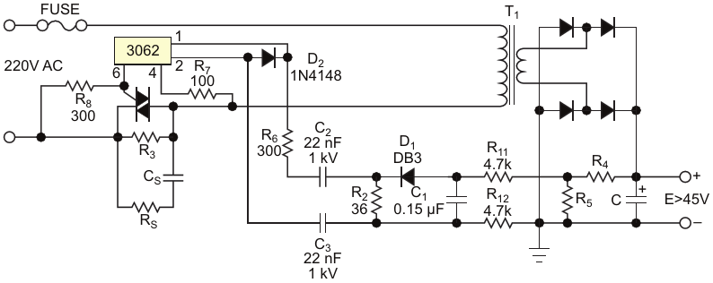

voltage divider, you can use the same dynistor to sense capacitor voltages greater than 45 V

Circuit controls inrush current in ac-operated power supplies

Figure 1. This circuit uses a dynistor to create a 700-Hz oscillator when the voltage on the filter capacitor reaches 32 V
Figure 2. By using the R
