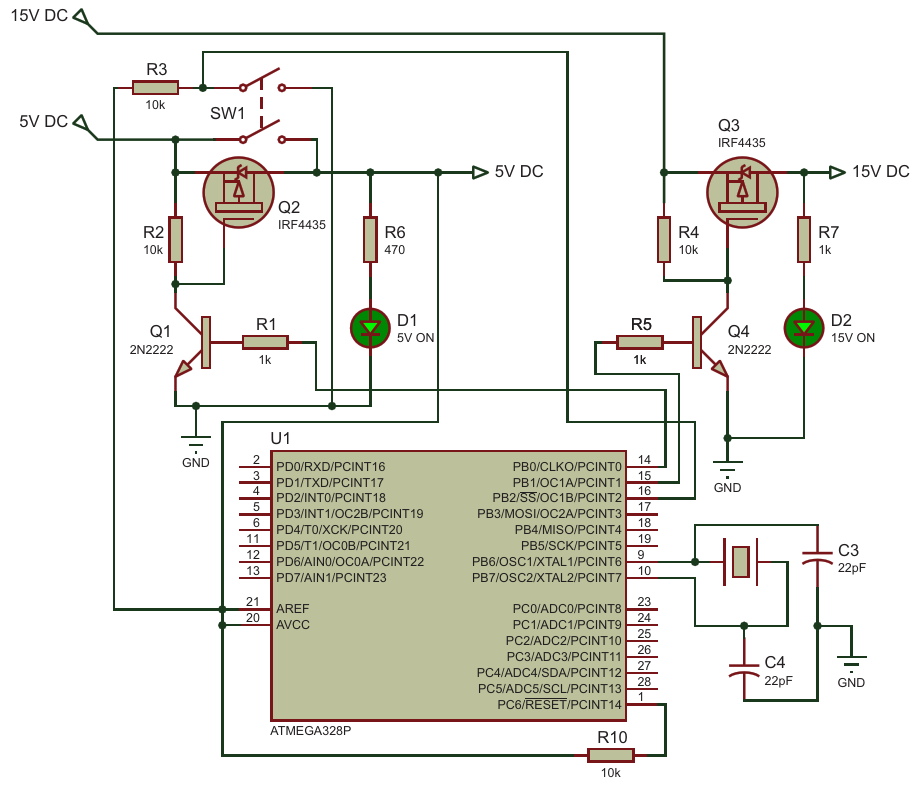

Single pushbutton switches on or off 5 V and 15 V supplies sequentially. LEDs D1, D2 indicate the presence of 5 V and 15 V supplies. Adequate heat sinks may be provided for Q2 and Q3, depending upon the load currents. Suitable capacitors may be added at t

Main DocumentArticle «Short push, long push for sequential operation of multiple power supplies»

Single pushbutton switches on or off 5 V and 15 V supplies sequentially LEDs D1, D2 indicate the presence of 5 V and 15 V supplies Adequate heat sinks may be provided for Q2 and Q3, depending upon the load currents Suitable capacitors may be added at t
