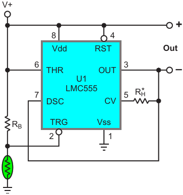

Basic bang bang heating configuration. Setpoint thermistor resistance = RB/2. Optional RH sets desired temperature hysteresis. Output rated at up to 15 volts and 300 mA = 4.5 W
AuthorsStephen Woodward
Main DocumentArticle «LM555 begets basic bang bang thermostat»
DescriptionFigure 1
File Format / SizePDF / 14 Kb
Basic bang bang heating configuration Setpoint thermistor resistance = R sub B /sub /2 Optional R sub H /sub  sets desired temperature hysteresis Output rated at up to 15 volts and 300 mA = 4.5 W
