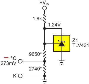

This precision voltage reference …
This precision voltage reference converts Kelvin to Celsius

Figure 2. This precision voltage reference converts Kelvin to Celsius
