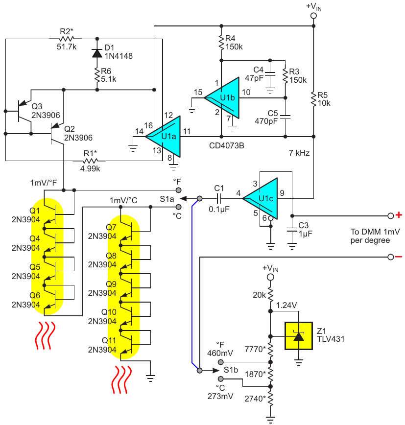

Switch U1a and current …
Switch U1a and current mirror Q2Q3 apply an excitation current ratio of 10.23:1 to the 9-sensor transistor string. The string is tapped at 5 × 200 µV/°C = 1 mV/°C and 9 × 111 µV/°F = 1 mV/°F
Stephen Woodward
ΔVbe thermometer is switchable between °C and °F
Figure 1
24 Kb
