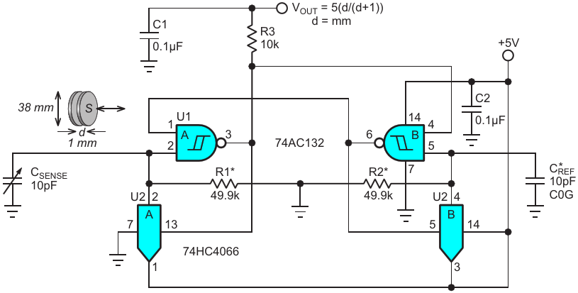

U1a and U1b cross-coupled …
U1a and U1b cross-coupled Schmidt trigger timers form a ~1 MHz RC multivibrator
Stephen Woodward
~0.1% resolution capacitive position sensor
Figure 1
19 Kb
Figure 1. U1a and U1b cross-coupled Schmidt trigger timers form a ~1 MHz RC multivibrator
Figure 2. This graph shows sensor performance when V
OUT
is connected to a 12 bit ADC using +5 V for its reference. The black curve (left axis) = plate separation (d) in millimeters, while the red curve (right axis) = ADC least significant bit (LSB) resol
