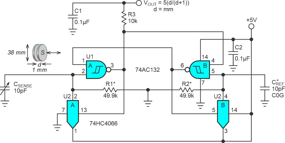

For that, we’ll need an interface circuit. The one in Figure 1 is a suitably simple match for the simplicity of the capacitive sensor itself, consisting of just 8 inexpensive off-the-shelf (OTS) parts. Here’s how it works.
U1a and U1b cross-coupled Schmidt trigger timers form a ~1 MHz RC multivibrator.
Figure 1. U1a and U1b cross-coupled Schmidt trigger timers form a ~1 MHz RC multivibrator.
For the example sensor dimensions and parts values, VOUT duty factor (x)
U1a and U2a form an RC timer with a time constant equal to R1·CSENSE while U1b and U2b do the same job for R2·CREF. Cross coupling them as shown in Figure 1 creates a square wave oscillator whose ~1 MHz cycle on U1 pin 3 consists of dwelling at +V for TREF = 50 kΩ·CREF = 500 ns and at zero for TSENSE = 50 kΩ·CSENSE = 500 ns / d where d, as earlier, is measured in mm.
Thus, the VOUT duty factor
Starting from
a bit of rearranging yields x(d + 1) = d, then xd + x = d, x = d(1 – x), and finally

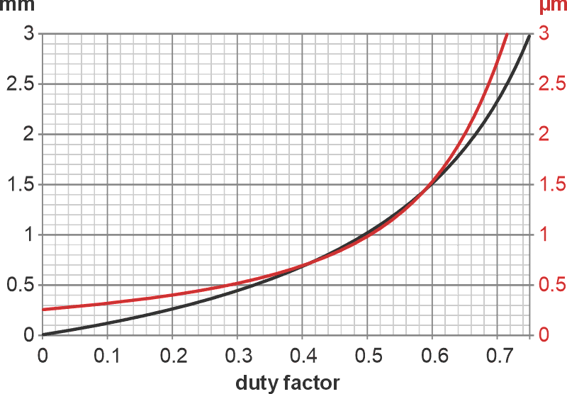

Figure 2 shows how this math performs when the VOUT signal is fed into a 12 bit ADC.
~0.1% resolution capacitive position sensor
Figure 2. This graph shows sensor performance when VOUT is connected to a 12 bit ADC
using +5 V for its reference. The black curve (left axis) = plate separation (d) in
millimeters, while the red curve (right axis) = ADC least significant bit (LSB)
resolution in micrometers. Note that the resolution is close to 0.1% (d/1000)
over much of the range.
Details of circuit operation include the inherent matching and tracking of U1’s gates simply because they share the same chip, and of accurate duty factor digitization if the connected ADC uses +5 V as its reference voltage. Asterisked parts (R1, R2, and CREF) are precision types. Stray wiring and layout capacitances should be scrupulously minimized.
If there’s a chance the sensor plates might come into contact and short out, then it’s a good idea to protect U2 with a series capacitor. 0.1 µF (from the same bag as C1 and C2) will work well and be sufficiently larger than CSENSE such that its precision and stability (or lack of thereof) won’t matter. I’d also put another one in series with CREF, although it’s not strictly necessary, just so things look more balanced.
If your application needs position sensing in two dimensions (e.g. an XY stage), the other halves of U1 and U2 are ready and willing, which helps to keep things capaciously and suitably simple!
