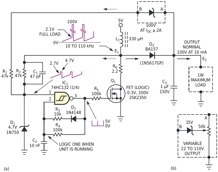

The output voltage of …
The output voltage of a simple variable-frequency dc/dc step-up converter depends on the device under test's breakdown voltage (a). To use the circuit as a variable medium-voltage power supply, replace the device under test with a network (b)
John Jardine
Zener test circuit serves as DC source
