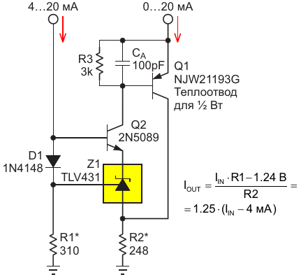

4mA-20mA to 0mA-20mA converter's current mirror drives grounded load
Figure 1
17 Kb
Figure 1. The current conversion circuit
Figure 2. This circuit adds an active current mirror to its predecessor to drive a grounded load
