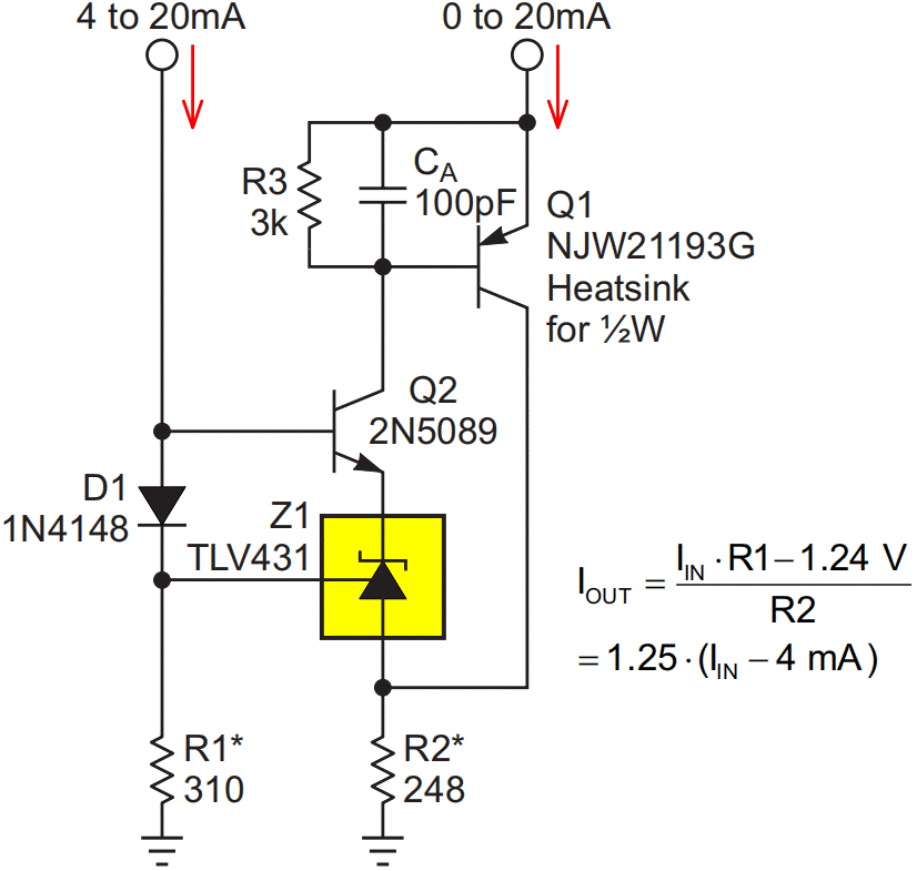

The ubiquity of the 4 to 20 mA current loop in analog process monitoring and control creates possibilities for peculiar designs of circuits for unusual accessory functions. Figure 1 shows an example. It does precision conversion of 4-20 mA to 0-20 mA. That’s useful for accommodating analog inputs that wouldn’t like a 4 mA zero offset.
Схема преобразования тока.
Figure 1. The current conversion circuit.
The core of the circuit is the VIN = I·R1 = 1.24 V to 6.20 V developed by the 4 mA – 20 mA input working into R1 and sensed by the VREF input of Z1. The principle in play is discussed here (Ref. 1).

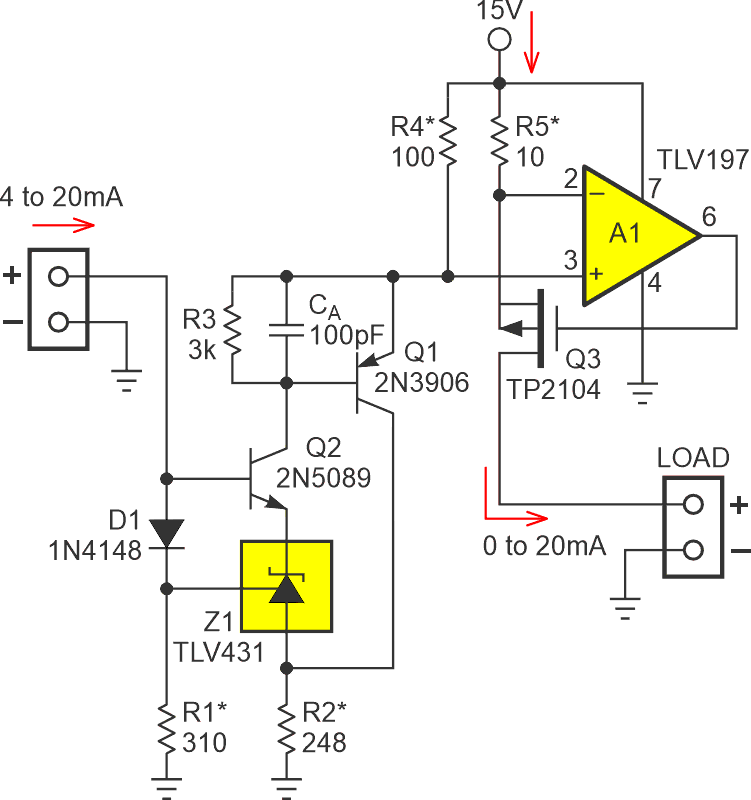

A potentially annoying shortcoming of the Figure 1 design, however, is its current sink output that’s referred not to ground but to the V+ source node, which needs to be at least 8 V. Figure 2 offers an accurate and straightforward fix: an active current mirror as described here (Ref. 2).The input max overhead voltage is 8 V.
This circuit adds an active current mirror to its predecessor to drive a grounded load.
Figure 2. This circuit adds an active current mirror to its predecessor to drive a grounded load.
References
  1. Woodward, Stephen. "Full circle current loops: 4mA-20mA to 0mA-20mA."
  2. Woodward, Stephen. "Active two-way current mirror."
