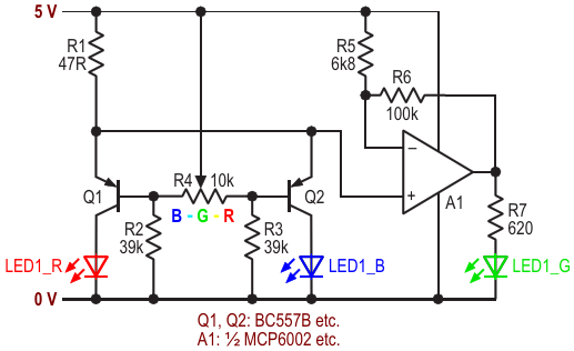

Rearranging the circuit and adding an op-amp to drive the green LED gives better, more linear control of the LED currents

Figure 3. Rearranging the circuit and adding an op-amp to drive the green LED gives better, more linear control of the LED currents
