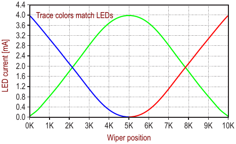

Figure 1. The red and blue LEDs are driven by a long-tailed pair and controlled by pot (potentiometer) R4, whose wiper voltage varies according to its position and is used to control the green LED's drive, producing a decently wide spectrum
Figure 2. This graph plots the LED currents against pot rotation
Figure 3. Rearranging the circuit and adding an op-amp to drive the green LED gives better, more linear control of the LED currents
Figure 4. The response of the revised design has more linear curves, giving a smoother spectrum
