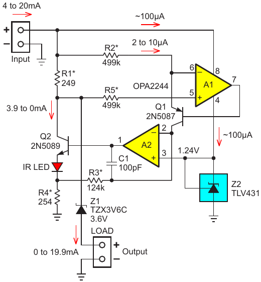

In this circuit, the 4-20 mA input current is converted to a 0-20 mA output while relying solely and exclusively on the input current for (phantom) power. Power-theft-related error is minimized by recycling the same 100 µA that runs the opamps to al
AuthorsStephen Woodward
Main DocumentArticle «Current converter performs purely on paltry phantom power»
DescriptionFigure 1
File Format / SizePDF / 17 Kb
In this circuit, the 4-20 mA input current is converted to a 0-20 mA output while relying solely and exclusively on the input current for (phantom) power Power-theft-related error is minimized by recycling the same 100 µA that runs the opamps to al
