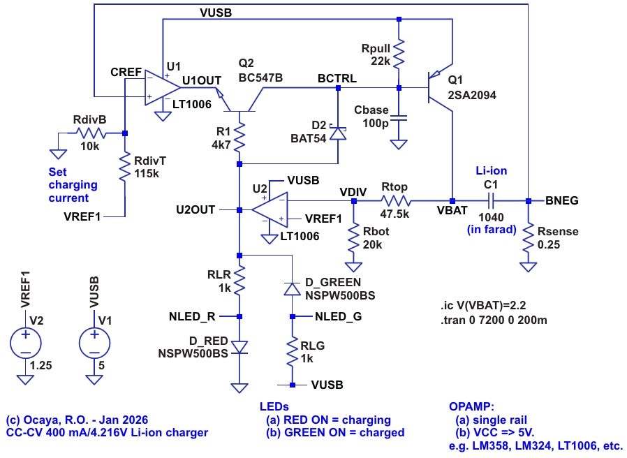

Schematic of the dual-loop linear Li ion charger. The schematic shows the key nodes that are referenced and plotted in the LTSpice simulation. In practice, a 1N4007 diode for D2 also worked well

Main DocumentArticle «Build a practical 400 mA linear Li-ion charger with visible CC-CV behavior»

Schematic of the dual-loop linear Li ion charger The schematic shows the key nodes that are referenced and plotted in the LTSpice simulation In practice, a 1N4007 diode for D2 also worked well
