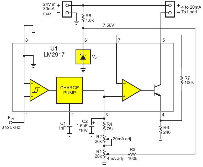

In this circuit, the LM2917 needs no added actives to make a frequency to 4-20 mA current sink converter

Hz to 4-20mA or 0-20mA current source is compatible with grounded loads

Figure 1. In this circuit, the LM2917 needs no added actives to make a frequency to 4-20 mA current sink converter
Figure 2. Four frugal extra external parts (bringing the total to 13) convert Figure 1 into a flexible current source that's useful if the load is grounded
