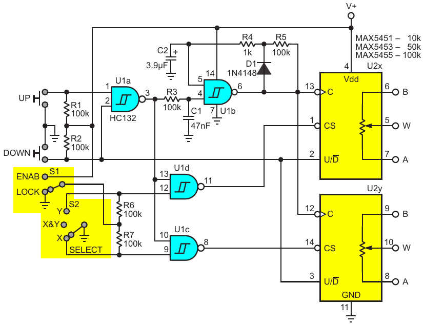

The 256-step (8-bit) resolution, dual-channel DPOT U2 can be programmed up/down with single step-per-push or auto-repeat (button held), with operating mode options including channel X or Y alone per switch S2's position on X or Y, both ganged together wit
AuthorsStephen Woodward
Main DocumentArticle «Double DPOT programming: Parallel gang-up, singleton, or none»
DescriptionFigure 1
File Format / SizePDF / 19 Kb
