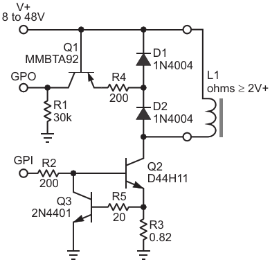

In this circuit, driver transistor Q2's PWM duty cycle varies from 100% at actuation to a power saving 50% sustain. It can accommodate load currents up to half an amp. R5 protects current limiter Q3's base-emitter junction from destruction by over-current

In this circuit, driver transistor Q2's PWM duty cycle varies from 100% at actuation to a power saving 50% sustain It can accommodate load currents up to half an amp R5 protects current limiter Q3's base-emitter junction from destruction by over-current
