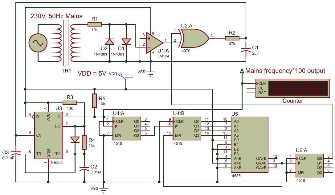

This circuit multiplies the …
This circuit multiplies the AC mains frequency by 100 and displays the result using a simple counter scheme. The component values shown assume a 50 Hz mains source
Jayapal Ramalingam
Measure the AC mains frequency with an ordinary counter
Figure 1.
