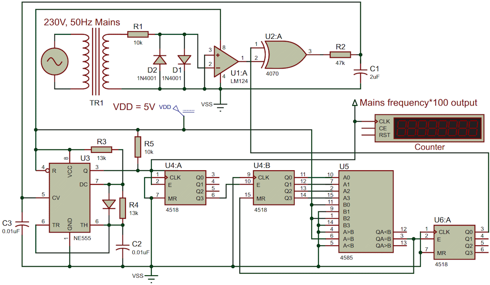

What is the alternative? If you can multiply the frequency by 100 and then feed it to the counter, the counter will read 5000 within a gating time of 1 second, which can be made to show 50.00. You will get a resolution of 0.01 Hz while keeping the gating time as 1 second. This is what’s done by the circuit in Figure 1, which implements a by-100 frequency multiplier based on a modified PLL (phase lock loop).
This circuit multiplies the AC mains frequency by 100 and displays the result using a simple counter scheme. The component values shown assume a 50 Hz mains source.
Figure 1.  This circuit multiplies the AC mains frequency by 100 and displays the result using a simple
How does it work?
  • Transformer T1 gives an output of 6 V AC; this same transformer can be used to produce 5 V DC required to power the circuit. U1A is used as zero cross detector, whose output is the mains waveform converted to a square wave with a 50% duty cycle.
  • The 6 V AC output routes to pin 1 of U2A, an exclusive OR gate. This IC acts as a phase detector.
  • U3, a 555 timer, functions as 5,000 Hz square wave generator.
  • This frequency is divided by 10 using U4A, a 4518 counter.
  • U4B, another 4518 counter, and U5, a 4585 comparator, operate as a frequency divide-by-5 circuit. In digital comparator U5, another 4585, inputs A0, A1, A2 and A3 are connected to the outputs Q0, Q1, Q2 and Q3 of the U4B previous stage. Input B3, B2, B1 and B0 are hardwired as 0101 (5). When the count in U4B reaches 5, its A=B output sends a pulse to U6A (another 4518 counter) and resets U4B so that it starts counting from zero again.
  • U6A’s Q0 output divides the input frequency by 2.
  • Thus, the combination of U4A, U4B, U5 and U6A operates as divide-by-100 circuit.
  • This divide-by-100 output is connected to pin 2 of U2A, again acting as phase detector.
  • U2A’s output feeds a low-pass filter circuit formed by R2 and C1, and is then connected back to pin 5 of the 555, circuit which works as voltage-controlled oscillator (VCO).
  • Thus, the PLL circuit closes and the 555 output is then read in the counter as the AC mains frequency multiplied by 100.
If the mains frequency variation is in a narrow range of, say, 48 to 52 Hz, this PLL circuit works nicely. The power supply and ground pins of the digital ICs are not shown in the circuit diagram.
Note that since the divide-by-10 output of the 4518 IC is not a square wave with 50% duty cycle, the divide-by-10 second stage was done in two parts: divide-by-5 and divide-by-2, thus solving the challenge of the closing of the phase lock loop.
