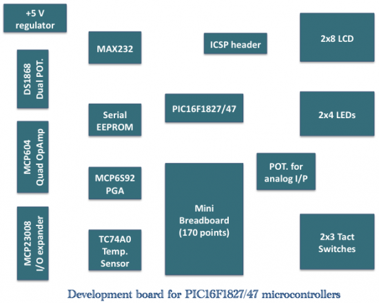

A development board is very helpful while exploring the different features of any microcontroller. It saves your time of wiring the circuit on a breadboard to do an experiment and later modify it for another experiment once you finished with the previous one, and so on. The development board allows you to perform any experiment or develop a project with minimum amount of effort and time. There is no standard circuit diagram for a microcontroller development board. It’s up to you what features you want on the board. Here’s what I decided to have on my board:
  • An ICSP header to connect PIC16F1847 to PICkit3
  • On-board voltage regulator (+5 V)
  • A HD44780 based character LCD display
  • 8 LEDs to read the status of output pins
  • 6 Tact switches for providing inputs
  • A potentiometer for providing analog input
  • TTL to RS232 voltage level translation and vice-versa for serial interface
  • An external serial EEPROM (24LC512)
  • A GPIO expander (MCP23008)
  • Quad OpAmp IC (MCP602) for signal conditioning
  • Digital potentiometers (DS1868)
  • Programmable gain amplifiers (MCP6S92)
  • A temperature sensor (TC74A0)
  • A mini breadboard
The layout of these components on the board is shown below. I soldered these components on a 18 cm × 12.8 cm experimenters circuit board. The PIC16F1827/47 is peripheral rich and each I/O pin serves multiple functions. Therefore, none of the I/O pins of PIC16F1827/47 are dedicatedly connected to any other peripheral components. Rather, individual pins are made easily accessible through double row female headers so that we can connect every peripheral device to whatever pins of PIC16F1847 we want to.
Layout of the components
