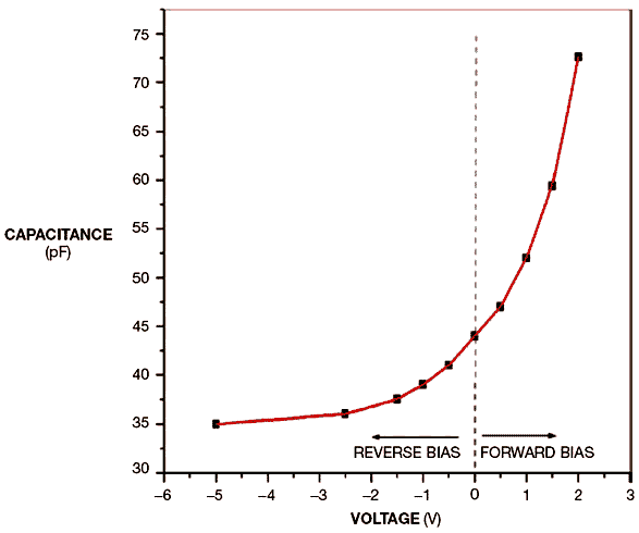

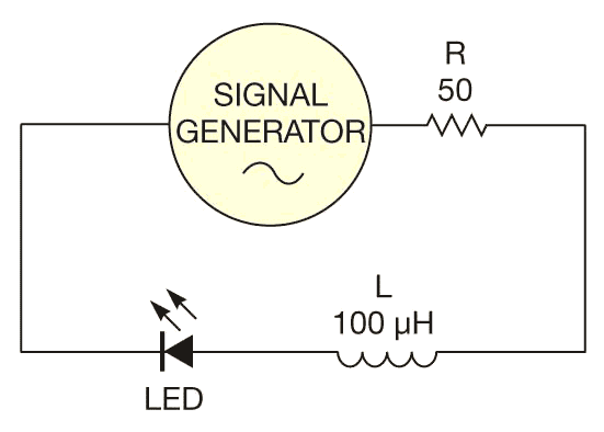

You can verify this calculation with a simple circuit using a blue LED in series with an inductor (Figure 1). The knee voltage of the LED is 2.45V, and the signal generator has an internal resistance of 50Ω. An inductance of 100 μH and the 50-pF capacitance of a typical LED yield a Q of 28. The amplitude of the sinusoidal signal generator is set at 650 mV p-p. You can then vary the generator’s output frequency until you see the circuit’s resonant point. As the circuit approaches the resonant frequency, the voltage across the LED starts to increase. The resonant point manifests itself as a small jump in voltage, rather than a smooth progression, due to a positive feedback at resonance. The positive feedback happens because the capacitance of any PN-junction device is not linear (Figure 2). As the circuit approaches the resonant frequency, the LED voltage increases, which also increases the LED capacitance, resulting in lower resonant frequency.

Figure 1. In this LRC circuit, the resistance is the source resistance of the sine-wave generator. The LED provides the capacitance.

Figure 2. The junction capacitance of an LED increases as you go from a reverse bias of −5V to a forward bias of 2V.

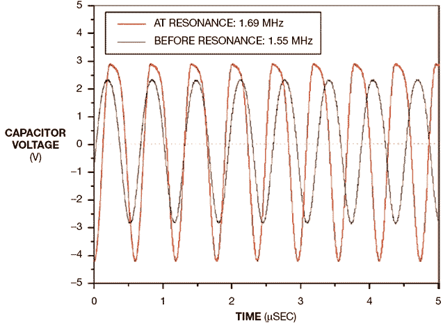

For a blue LED, the voltage waveform as the circuit approaches resonance is 1.55 MHz. The circuit settles at 1.69 MHz (Figure 3). The forward-biased LED is thus emitting light, clipping the positive parts of the boosted waveform. Using the same 650-mV-p-p generator amplitude on other colors of LEDs produces different resonant frequencies. You can see a similar effect with a square-wave generator because it also contains the fundamental components of the resonant frequency.

Figure 3. Tee effect of the LED capacitance increasing with applied voltage means the circuit will jump to a frequency as you approach the resonant point.
