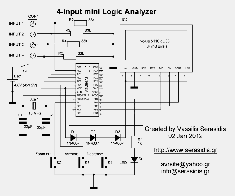

Schematic of the circuit.
mini Logic analyzer on AVR
Click to enlarge
The operating voltage of the circuit is 4.8V DC from 4×1.2V rechargeable batteries. Switch on the S1 to power on the electronic circuit. After the initial screens on LCD you will see a message that the Atmel AVR ATmega8 waits for a signal change on input pins. The AVR has 4 external pull-down resistors 33k (R2-R5) avoiding any unnecessary trigger on any input pin because of an external electromagnetic field or by touching accidentally your hand on any input pin. The Nokia 3310/5110 LCD works from 3.3 - 5V power supply. The problem is that the LCD's backlight works with Maximum 3.3V DC. So I put diodes D1-D3 to decrease the voltage from 4.8V to 4.8-(0.7×3)=2.7V that is the required power supply of Nokia's LCD. When you power ON the circuit, the LED1 is turned OFF. After the first trigger on any of 4 input pins, this LED is turned ON and the AVR starts capturing the data in to its internal RAM buffer (290 samples).
ATTENTION!!!
Do not use regular alcaline 1.5V batteries instead of rechargeable. The total voltage is 4 × 1.5 = 6V. This voltage will probably burn the LCD and the AVR microcontroller.

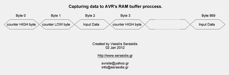

The data capturing process.
As you can see on Picture 5 the data buffer is constituted by 870 bytes (v1.00) 2 for the counter and one for the input pins information. In version 1.01 the data buffer was decreased to 256×3=768 bytes for increasing the capturing speed because the buffer size variable is 8 bit instead of 16 bit that I used before. The next byte calculations must be done according to the firmware version you use.
How it works? It is simple. After the power ON the AVR waits for a trigger pulse on any of 4 input pins. If a trigger pulse is detected the AVR starts counting the time is needed for the next trigger on any of the 4 input pins. The sample length is stored in a 16-bit variable named "counter". When this variable overflows, the status of the 4 input pins and the counter value are stored in the buffer and its address is increased by 3 (2 bytes for counter and 1 byte for input pins data). This process is been made until the AVR fills all the buffer bytes (870/3 = 290 samples or triggers). When the AVR fills the buffer, all the data are appeared on LCD as a graph. You can move the graph to the left ( button S3) or to the right (button S4) to watch the entire data sequence. If the data sequence is in a low speed you can shrink the graph (zoom out) with a 2, 4, 8, 16, 32, 64, 128, 256, 512, 1024, 2048, 4096 or 8192 ratio by pressing the S2 button.
