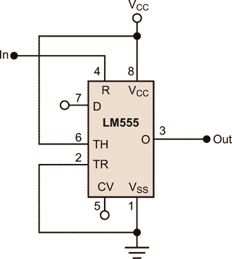

Figure 1. By using the LM555’s reset pin as the input, the timer can serve as a buffer circuit driven by standard logic levels from 1.8 to 5 V.
To implement a buffer function, configure the timer’s reset line (pin 4) as the input (Fig. 1). This provides a transition level of 0.5 to 1 V, allowing the device to be driven directly by standard 5-, 3.3-, and even 1.8-V logic regardless of the VCC level. Alternatively, the trigger line (pin 2) may serve as an active-low enable line, although this line does not have the same compatibility as the reset pin in terms of levels.

With its 200-mA sink/source capability, an LM555 powered by 12 or 15 V can drive most MOSFET/IGBT gates at frequencies exceeding 250 kHz without clamping diodes on the gate, minimizing cost. When driving gates, you should place a 5- or 10-Ω resistor in series with the output to minimize ringing and transient currents. In addition, the circuit should include a ceramic or tantalum bypass capacitor or at least 1 µF to provide the surge currents required.
Both of the circuits also provide an additional open-collector output on the discharge pin (pin 7) that could be set to any voltage level, up to 18 V. You can let the control voltage pin (pin 5) float, or you could use it to change the internal comparator threshold levels.
