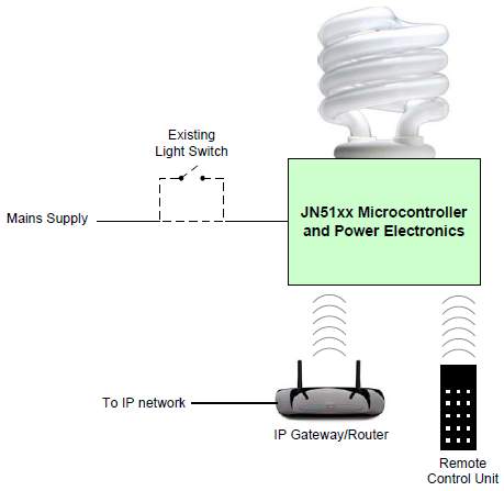

This application note is concerned with a ‘smart lamp’ which can be controlled via a radio link from a wireless network device, such as a remote control unit or an IP gateway/router (it may also be controlled from a pre-existing wired switch).
The smart lamp contains an NXP JN51xx wireless microcontroller to handle control commands received over the radio. This device is connected to a lamp driver IC which controls the Solid State Lamp (SSL) or Compact Fluorescent Lamp (CFL).
