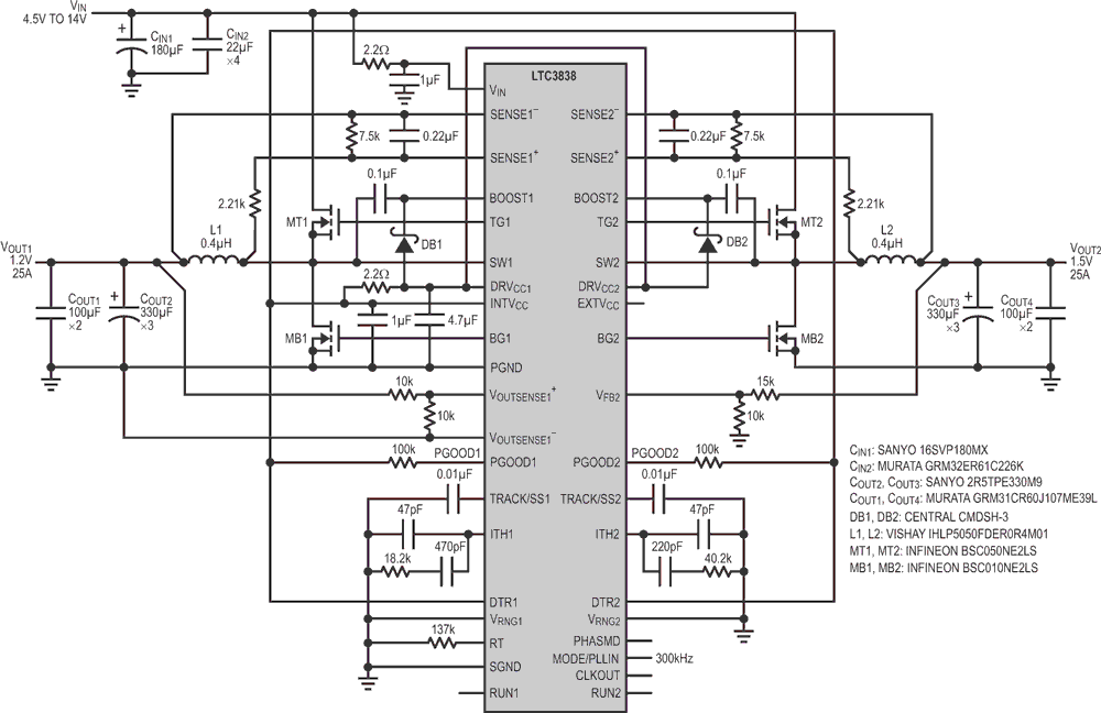

1.5 V/25 A and 1.2 V/25 A Buck Converter
| Figure 1. | Dual Output, 1.5 V/25 A and 1.2 V/25 A Buck Converter Operating at FSW = 300 kHz. |

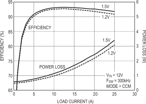

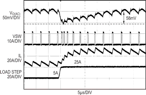

Figure 1 shows a dual 25 A output buck converter synchronized to an external 300 kHz clock. The controlled constant on-time valley current mode architecture allows the switch node pulses to temporarily compress when a 5 A to 25 A load step is applied to the 1.2 V rail, resulting in a voltage undershoot of only 58 mV (see Figure 2). The full load effi ciency for the 1.5 V and 1.2 V rails is 91.8% and 90.8%, respectively, as shown in Figure 3. The high efficiency is realized by the strong gate drivers, optimized dead time and DCR sensing.
| Figure 2. | 20% to 100% Step Load Response of the 1.2 V Rail at VIN = 12 V, FSW = 300 kHz, Mode = FCM. |

| Figure 3. | Efficiency and Power Loss of the 1.5 V/25 A and 1.2 V/25 A Converter. |

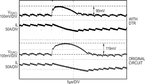

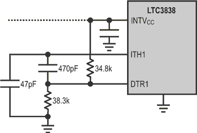

An innovative feature of the LTC3838 is the load release transient detect feature. The DTR pin indirectly monitors the output voltage by looking at the AC-coupled ITH signal. If the inferred overshoot exceeds a user set value, the bottom FET turns off. This allows the inductor current to slew down at a faster rate, which in turn reduces the overshoot. Per Figure 4, a 32% reduction in the overshoot is realized on the 1.2 V rail. Greater improvements occur at lower output voltages.
| Figure 4a. | Implementation of the Detect Transient Feature on the 1.2 V Rail. |
Figure 4b. | 100% to 20% Step Load Response of the 1.2 V Rail with and without the Detect Transient Feature, VIN = 12 V, FSW = 300 kHz, Mode = FCM. |
