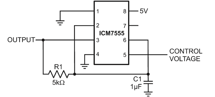

Method 1: Use a Low-Power Timer as a PWM Generator
In this method an ICM7555 timer is configured as in Figure 1.
Simple solutions for a single-device PWM waveform generator
Figure 1. A PWM generator and timer for a single device.
In Figure 1 the pulse width of the output at Pin 3 is modulated by the control voltage (VCONTROL) applied at Pin 5. Lab tests were done on the design with the power supply set at 5 V. Figures 2 through 5 show the PWM output at three different control voltages, 1 V, 2 V, and 4 V. C1 is charged to VCONTROL by the supply voltage (VSUPPLY) and discharged from VCONTROL/2 to ground. When no external control voltage is applied, VCONTROL is at 2/3 of VSUPPLY.
Figure 2. PWM output with control voltage = 1 V
Figure 3. PWM output with control voltage = 2 V
Figure 4. PWM output with no control voltage
Figure 5. PWM output with control voltage = 4 V
The data illustrate how the control voltage applied at Pin 5 changes the threshold voltage of the two internal comparators. Without the applied control voltage (Figure 4), the device sets the charging and discharging of C1 at 1/3 and 2/3 of the supply voltage. This is equidistant from the supply voltage and ground, thus effecting a 50% duty cycle. The different control voltages change the charging time for C1 to reach VCONTROL and the discharging time for C1 to discharge to VCONTROL/2. This process alters the pulse width of the output waveform.
The charging time is expressed as:
Where R = R1 and C =C1.
The discharging time is expressed as:

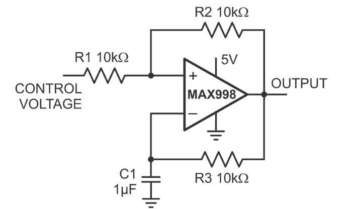

Method 2: a PWM Generator with Comparator
In this method a MAX998 comparator is configured as in Figure 6.
Figure 6. A PWM generator and comparator
The pulse width of the output is modulated by the control voltage applied at R1. Lab tests were done with the power supply set at 5 V. Figures 7 through 9 show the PWM output of three different control voltages, 1 V, 2 V, and 3 V.
Figure 7. PWM output with control voltage = 1 V
Figure 8. PWM output with control voltage = 2 V
Figure 9. PWM output with control voltage = 3 V
The control voltage applied to the MAX998 sets the threshold voltages at which charging and discharging occur. The upper threshold voltage is
and the lower threshold voltage is VCONTROL/2.
