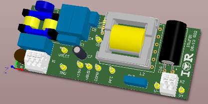

The IRuFB1 40 W Isolated Flyback PFC design is presented in this document. This power supply circuit provides power factor correction (PFC), output voltage regulation and full protection against over-current/over-voltage conditions. Schematic, BOM, PCB layout example are included in this application note as well as a detailed design aid for circuit dimensioning. The circuit comprises a one-stage Flyback DC/DC converter operating in Critical Conduction Mode (CRM), controlled by the IRS2505L PFC control IC, ensuring high power efficiency, compact size, low cost and excellent power factor and THDI figures.
