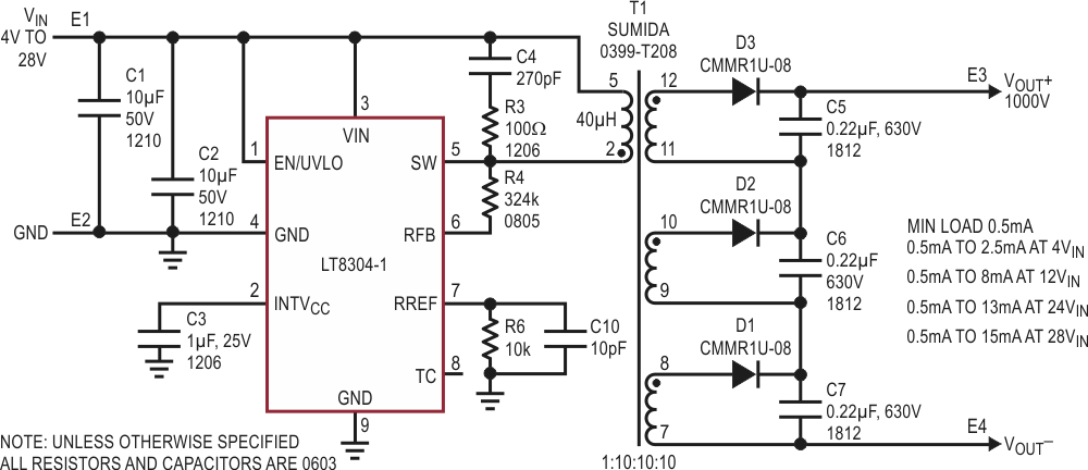

1000 V/15 mA Output, from a 4 V–28 V Input
An LT8304-1 flyback converter design features a low component count. Figure 1 shows a complete 4 V–28 V input to 1000 V output solution capable of supporting 15 mA loads. The output current capability increases with input voltage, reaching 13 mA when the input voltage is greater than 24 V. The LT8304-1’s ability to sense the output voltage through the primary-side waveform eliminates the need for a bulky high voltage divider, and no-opto coupler is required.
1000V Output, No-Opto Isolated Flyback Converter
Figure 1. A Complete 1000 V/15 mA Isolated Flyback Converter from a 4 V–28 V Input.
The guidelines for calculating voltage and current stress on the components surrounding the LT8304-1 are detailed in the LT8304-1 data sheet. Notably, this 1000 V solution uses a transformer with three split-output windings on the secondary side. The primary side to secondary side turns ratio is 1:10:10:10, instead of a single-secondary-winding 1:30 transformer. The 1:10:10:10 transformer enables the output voltage stress to be split among three high voltage output diodes and three high voltage output capacitors. Individual component voltage ratings need only be one-third of the total voltage, facilitating more options for output diode and output capacitor selection.
