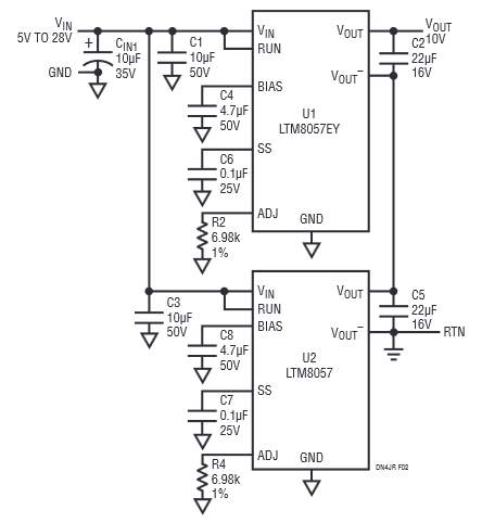

The LTM8057 and LTM8058 UL60950-recognized 2 kV AC isolated µModule converters will be used to demonstrate this design approach, which can also be applied to the LTM8046, LTM8047 and LTM8048. Let's assume an output of 10 V at 300 mA is desired from a 20 V input. Reviewing the maximum output current curve, we notice that a single LTM8057 is insufficient to meet the output current requirement under these conditions.
However, upon noticing that a single LTM8057 can deliver 300 mA at 5 V from a 20 V input, a solution becomes apparent. Since the output voltage is isolated from the input, the outputs of two LTM8057s set at 5 V can be connected in series to achieve a 10 V output at 300 mA.

 Two LTM8057 Modules with Outputs Connected in Series, Supporting a 10 V, 300 mA Output Application from 20 Vin
