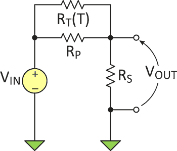

Figure 1 shows the thermistor linearization circuit that I am addressing in this Design Idea. The temperature of the thermistor is linearly related to the output voltage (approximately).
Linearize thermistors with new formula
Figure 1. Two-resistor thermistor linearization circuit.
The design process begins by picking a temperature, which I call the inflection temperature TI, at which we want the flattest possible transfer function (VOUT/VIN). My design task is to compute values for RS and RP given TI and the resistor ratio
at TI.
Three parameters, R0, β, and TREF, are often used with Eq. 1 to model the thermistor’s resistance versus temperature characteristic
  (1)
I determine RS and RP by setting the second derivative of VOUT/VIN in Figure 1 to 0 at temperature TI. After much algebra, I obtained the two formulas shown in Eq. 2.
  (2)

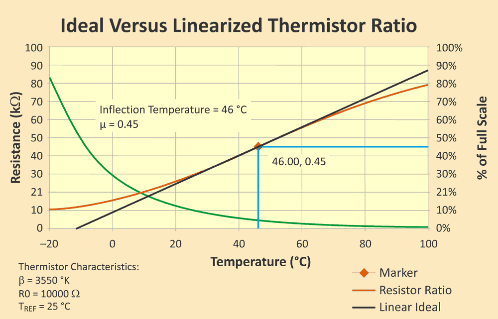

Figure 2 shows a graph of the linearized thermistor voltage transfer function for a common thermistor.
Figure 2. Graph of the linearized thermistor transfer function.
I have put together an Excel spreadsheet and a Mathcad worksheet that models this data, downloadable below.
