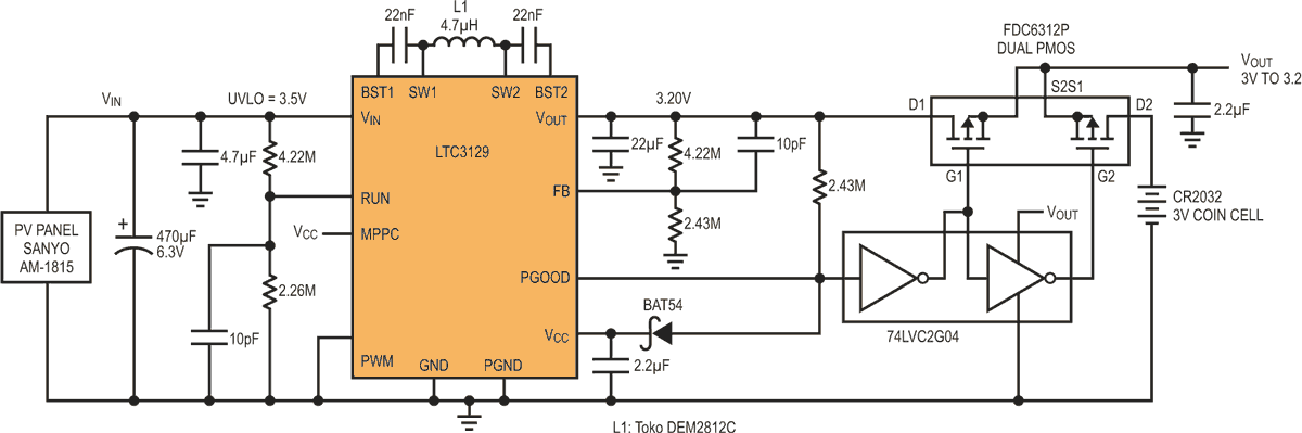

In many solar powered applications, a backup battery provides power when solar power is insufficient. Figure 2 shows an application where a primary lithium coin cell and a few external components have been added to the converter from the previous example to provide backup power to the output in the event that the light source is unable to provide the necessary power to maintain VOUT. The LTC3129 is used in this case, allowing VOUT be programmed for 3.2 V to better match the voltage of the coin cell.
15 V Buck-Boost Converters with Ultralow 1.3 μA Quiescent Current
Figure 2. Solar powered converter with coin cell backup.
In this example, the battery is used on the output side of the converter, and the LTC3129 is set to regulate VOUT slightly above the battery voltage. This assures that there is no load on the battery whenever VOUT can be powered by the solar input. In the event that VOUT droops due to insufficient light to power the load, the PGOOD output from the LTC3129 goes low, switching the load from the converter output to the battery, thus holding VOUT at the battery voltage. During this time, the converter's input and output capacitors are able to recharge (if some light is available), enabling the load to be periodically switched from the battery back to the converter by the PGOOD signal. In this manner the load is powered by the solar input as much as possible, and the battery is only used in a time-shared manner, extending its life.
The diode connected from PGOOD to VCC is used to hold PGOOD low during start-up, before VCC (and therefore PGOOD) is valid.

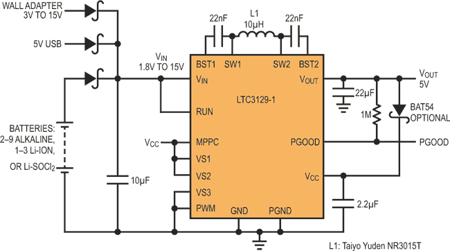

The ability of the LTC3129-1 to operate at high efficiency over a wide range of loads and input voltages with a minimal number of external components is illustrated in Figure 3. In this example, the output, which has been programmed for 5 V using the VS1-VS3 pins, can be powered from a 5 V USB input, a variety of battery options or a 3 V to 15 V wall adapter. The flexibility of running seamlessly from a wide variety of power sources is an asset in critical field applications, such as military radios.
Figure 3. Multi-input 5 V converter.

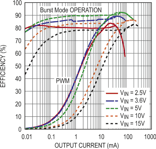

The LTC3129-1's low IQ of just 1.3 µA in sleep mode, combined with a high resistance internal feedback divider, enables it to maintain high efficiency over a wide range of loads, as shown in Figure 4. At a load current of just 100 µA, the efficiency is ~80% over nearly the entire VIN range. This is an important feature for extending battery life in applications that spend a large percentage of the time in a low power state.
Figure 4. Efficiency vs VIN and load of the 5 V converter in Figure 3.

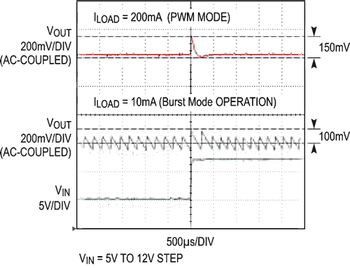

The line step response (VIN is stepped from 5 V to 12 V) is shown in Figure 5, with VOUT measured under both heavy and light load conditions. At a load of 200 mA, the part is operating in PWM mode, and VOUT overshoot is only 150 mV (3%). At a load of 10 mA, the part is in Burst Mode operation, with a burst ripple of 100 mVPK-PK (2%), and less than 100 mV of VOUT overshoot due to the line step.
Figure 5. Line transient response of the 5 V converter in Figure 3.
 The VCC pin is the output of an internal LDO that generates a nominal 3.9 V from VIN to power the IC. The LDO is designed so that it can be externally back-driven up to 5 V. In this example, an optional bootstrap diode is shown from VOUT to VCC.
The addition of this external bootstrap diode has two advantages. First, it improves efficiency at low VIN and high load current by providing a higher gate drive voltage to the internal switches, lowering their RDS(ON). Also, at high VIN and light load, it improves efficiency by reducing the power lost in the internal LDO used to generate VCC. (Note that the VCC pin must not be raised above 6 V, so it cannot be diode-connected to higher output voltages.)
The second advantage of adding a bootstrap diode is that it allows operation from a lower VIN. After start-up, if VCC is held above its minimum value of 2.2 V (by the output voltage in this case), then the converter can operate at a lower input voltage, down to 1.75 V, where the fixed internal VIN UVLO threshold is reached. This capability extends the usable voltage range enough to make it possible to run from two depleted alkaline batteries. Note that if the battery voltage is below 2.4 V and the converter is shut down (or VOUT is shorted), the IC is not be able to restart.

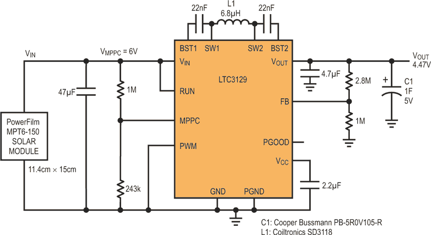

The LTC3129 and LTC3129-1 include a maximum power point control (MPPC) feature that allows the converter to servo VIN to a minimum voltage under load, as set by the user. Regulating VIN maintains optimal power transfer in applications using higher current solar cells or other sources with high internal resistance. This feature prevents the converter from crashing the input voltage when operating from a current-limited source.
The MPPC control loop operates by reducing the average inductor current commanded by the converter, thus maintaining the minimum programmed VIN voltage under load. This voltage is set using an external resistor divider connected to VIN and the MPPC pin, as shown in the supercapacitor charging example of Figure 6. The MPPC control loop is designed to be stable with a minimum input capacitance of 22 µF.
Figure 6. Outdoor solar powered supercapacitor charger with maximum
power point control.
 Note that reducing the inductor current under MPPC would cause the output voltage to droop if it were driving a conventional load. Therefore, most applications employing MPPC involve charging a large storage capacitor (or trickle charging a battery) from a solar cell. The MPPC feature assures that the capacitor or battery is charged at the highest current possible, while operating the solar cell at its maximum power point voltage.
It is important to note that when the LTC3129/LTC3129-1 is in MPPC control, Burst Mode operation is inhibited, and the VIN quiescent current is several milliamps, since the IC is switching continuously at 1.2 MHz. Therefore, MPPC is not appropriate for use with sources that cannot supply a minimum of about 10 mA. For applications requiring an MPPC-like function with very weak input sources, the accurate RUN pin should be used to program a UVLO threshold, as described in the example of Figure 1.

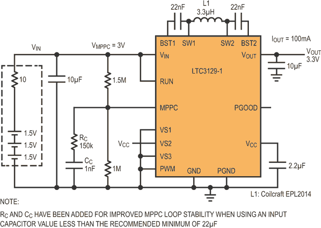

The MPPC feature can be used in other applications, including those designed for intrinsic safety, where the input source has a series current limiting resistor between it and the DC/DC converter. In this case, the MPPC loop prevents the LTC3129/LTC3129-1 from drawing too much current, especially during startup when the output capacitor is being charged, and crashing the input voltage. An example of this is shown in Figure 7, where the input voltage is maintained at a minimum of 3 V, as set by the MPPC divider.
Figure 7. 3.3 V converter using MPPC for intrinsic safety application.
In this case, because the input capacitor value is limited to just 10 µF for safety (less than the recommended minimum value of 22 µF when using MPPC), an additional RC compensation network is added to the MPPC pin for improved phase margin of the MPPC loop.
