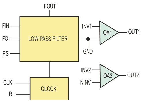

The solution is to use a filter with a built-in clock oscillator such as the MSELP fifth-order elliptic low-pass filter from Mixed Signal Integration (Figure 1). Similar ICs such as the higher-current (5 mA) LMF60 are available from Texas Instruments, under the legacy National Semiconductor designation.
Build Your Own RC-Programmable Wide-Bandwidth Bandpass Filter
Figure 1. The MSELP Block Diagram.
With the selectable 50:1/100:1 clock-to-corner-ratio pin and two uncommitted op amps, the clock-oscillator IC provides both an anti-aliasing filter and a reconstruction filter. Further, the clock output of the MSELP can drive another switched-capacitor high-pass filter. With a clock-to-corner frequency ratio of 1000:1, the MSHN6 sixth-pole high-pass/notch filter puts a decade between the corners of the bandpass filters.

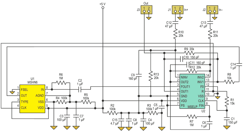

The circuit of Figure 2 is a 330-Hz to 3.3-kHz bandpass filter for Family Radio Service (FRS) radio or telephony. FRS radios are low-power, low-cost point-to-point units providing direct voice links between users without the need for an intermediate basestation or control node. They are especially useful in remote areas that lack cell-signal coverage or cell towers.
Figure 2. This circuit provides a wideband bandpass filter optimized for FRS applications, with a 10:1 ratio in its corner frequencies.
The corner of the reconstruction filter and the anti-aliasing filter is set for approximately 50 kHz. The design uses both anti-aliasing filters and reconstruction filters. The MSELP’s op-amp input provides both positive and negative inputs to the filter input. The MSHN6 and MSELP work down to 2.7 V dc. The circuit draws less than 1 mA. R1 and C1 set the oscillator frequency. With a 5-V supply, the frequency is:
For a 312-kHz clock, R1 is 15 kΩ and C1 is 150 pF (3.12-kHz low-pass and 312-Hz high-pass corners).
