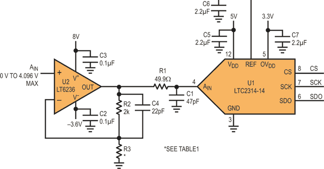

Figure 1 shows a non-inverting amplifier driving the LTC2314-14. The driver has a gain between one and ten depending on the value of R3, as shown in Table 1. Capacitor C1 and resistor R1 limit the input bandwidth to 68 MHz. C1 also acts as a charge reservoir for the ADC sample-and-hold capacitor and helps to isolate the LT6236 from the transient that occurs at AIN when the ADC goes into sample mode. R1 is also used to help isolate the op amp from the ADC sampling transient.

R3 (Ω)
GAIN
AINRANGE (V)
1
0 to 4.096
2k
2
0 to 2.048
499
5
0 to 0.8192
221
10
0 to 0.4096

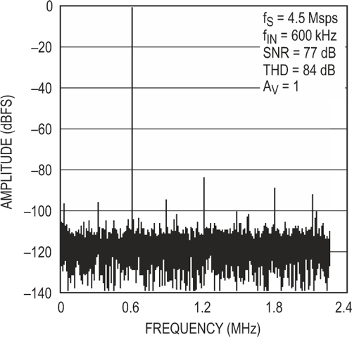

Figure 2. 16k-Point FFT for the Circuit of Figure 1.

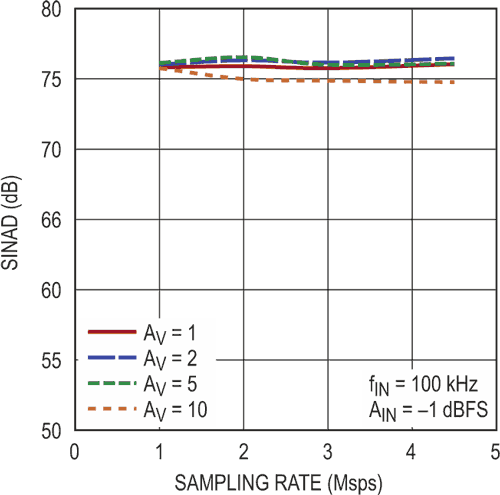

The FFT in Figure 2 shows that with a gain of one this circuit has an SNR of 77 dB and a THD of –84 dB, with a sampling rate of 4.5 Msps and a 600 kHz input frequency. These numbers are close to the typical data sheet performance specifications for the LTC2314-14 alone, indicating that there is minimal performance degradation of the ADC when using this driver. Figure 3 shows SINAD performance vs sampling rate for gains of one through ten. The SINAD remains about the same for all gains at approximately 75 dB to 76 dB, with sampling rates from 1 Msps to 4.5 Msps, which is the maximum rated sampling frequency for this part.
Driver for 14-Bit, 4.5 Msps ADC Operates Over a Wide Gain Range
Figure 3. SINAD vs Sampling Rate.

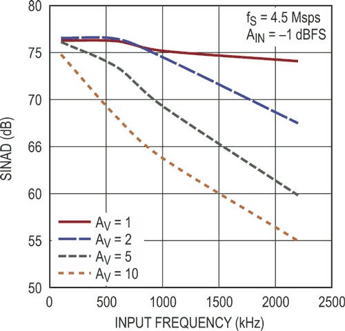

Figure 4 shows SINAD performance vs input frequency for gains of one through ten. The SINAD starts at 75 dB to 76 dB for an input frequency of 100 kHz but falls as the input frequency and gain rises. For most applications a drop in SINAD of 3 dB should be acceptable. At a gain of one, SINAD is reduced to 73 dB beyond 2.2 MHz. At a gain of two, SINAD is reduced to 73 dB at approximately 1.2 MHz. At a gain of five, SINAD is reduced to 73 dB at approximately 600 kHz. At a gain of ten, SINAD is reduced to 73 dB at approximately 250 kHz.
Figure 4. SINAD vs Input Frequency.
