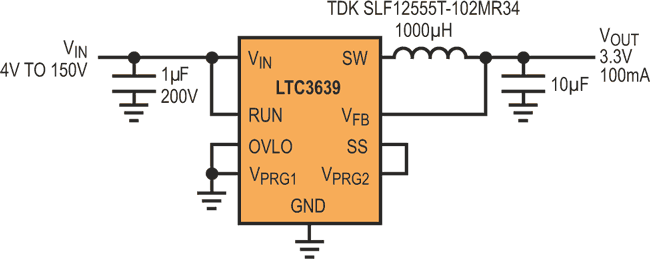

4 V to 150 V Input to 3.3 V Output, 100 mA Buck Converter
High Efficiency 100 mA Synchronous Buck Converter with Wide Input Range from 4 V to 150 V
Figure 1. 4 V to 150 V Input to 3.3 V Output, 100 mA
Synchronous Buck Converter.

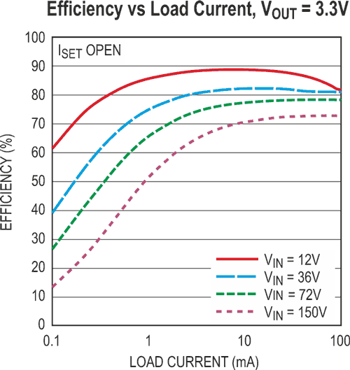

Figure 1 shows a 3.3 V output, 100 mA maximum load current synchronous buck converter, with wide input range from 4 V to 150 V. The LTC3639 has three programmable fixed output voltages 1.8 V, 3.3 V and 5 V. These fixed outputs use an internal feedback resistor divider and can be simply selected with the VPRG1 and VPRG2 pins. For 3.3 V output, just connect VPRG1 to ground and tie VPRG2 to the SS pin. The VFB pin is directly connected to the output without using an external resistor divider. Efficiency curves with different input voltages are shown in Figure 2.

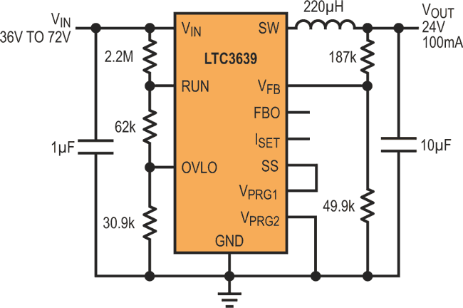

36 V to 72 V Input to 24 V Output, 100 mA Buck Converter
The LTC3639 has a very wide output voltage range, from 0.8 V to the input voltage. Besides the selectable three fixed output voltages, an adjustable output voltage can be set with an external resistor divider. Figure 3 shows an application example of a 24 V output, 100 mA synchronous step-down converter. The input voltage range is controlled from 36 V to 72 V, with the overvoltage lockout and undervoltage lockout features of the LTC3639. The input operating range is easily set with a resistor divider from the VIN to the RUN pin and the OVLO pin, as shown in Figure 3.

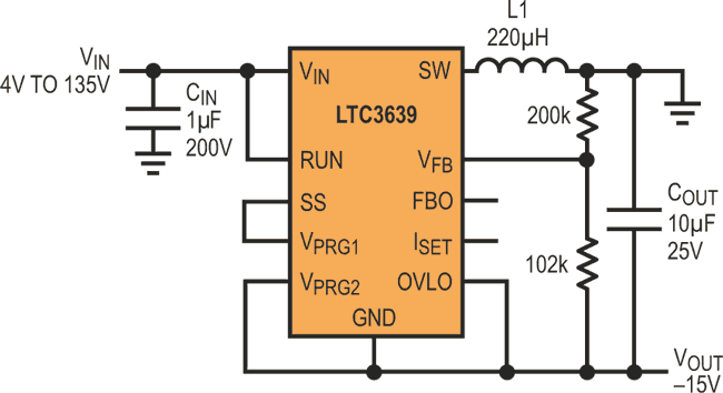

Negative Output Voltage Applications
Figure 4. 4 V to 135 V Input to –15 V Output
Positive-to-Negative Regulator.
An additional useful application for the LTC3639 is to generate a negative voltage from a positive one. The part’s wide voltage range makes even large negative output voltages realizable. Figure 4 shows the implementation of a –15 V output regulator from a 4 V to 135 V input. Since the output is connected to the ground pin, the maximum input voltage is limited to the sum of 150 V and the –15 V regulated output, or 135 V. The maximum output current for the LTC3639 in this positive-to-negative configuration is about
