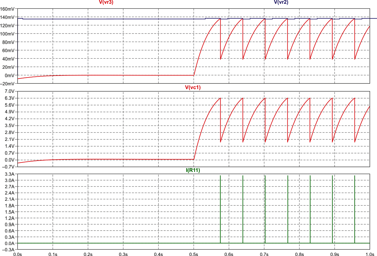

Figure 2. LTspice-simulated timing waveforms in the LED flasher/strobe. The current
in R10 is measured under the assumption that power LED D4 is not connected.
To use the circuit as a three-LED flasher/strobe, R10 should be 100 Ω. For the component values shown, the thyristor triggers when VC1 = 6.33 V. As soon as the thyristor has triggered, a pulse of about 2 V is applied to the base of Q4, turning it fully on. This causes a large Q4 collector current, which causes a quick discharge of C1. If this collector current occurs through a series of LEDs or a single power LED, it gradually brightens, until a brilliant flash is seen at the moment Q4’s base is driven hard. The discharge also turns off U1 (i.e., its supply voltage falls below 2 V). Therefore, VR2 reaches a minimum of about 43 mV before charging of C1 resumes and the process repeats. When flashing LEDs, a limiting resistance is required (R10) as LEDs will be destroyed without it. The simulation shows peak current pulses of 3.3 A with 50 µs duration measured at 50% (Figure 2). The rate of flashing can be adjusted by changing R2 or R11.
