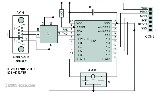

Probably many of AVR software developers that use AVRStudio4 environment would like to program chips directly from AVRStudio4 using AVRISP. Usually we use simplified version of AVRISP that work with PonyProg or AVRDUDE. But here is solution, that can solve this problem.
In sixca.com is populated simplified version of AVR ISP programmer that works with ATMEL original programming software.
avr isp schematics
avr isp schematics
IC1 stands for any RS-232 driver like MAX232 or any similar (DS275). Wire from AVR-ISP to AVR board should not exceed 15cm.

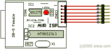

Installation of components:

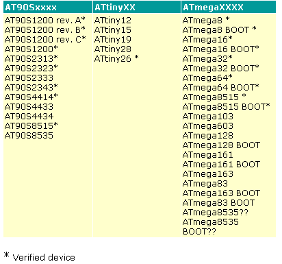

The firmware is written for AT90S2313 as this version of microcontroller is obsolete, then it should be working on Attiny2313 as this microcontroller is compatible with AT90S2313. This device can program most of AVR microcontrollers that support ISP:

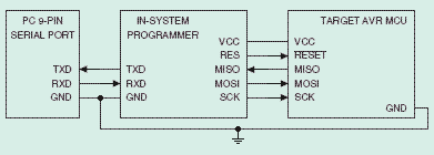

AVR ISP connection diagram:
