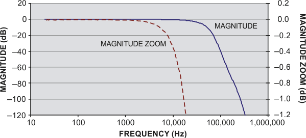

Figure 2. The measured amplitude-versus-frequency response of the circuit
in Figure 1 shows a change of scale on the right vertical axis.
Figure 2 shows the filter's measured magnitude response for a 1 V-rms input signal. The filter's passband gain of 0 dB is flat within 1.2 dB for frequencies as high as 20 kHz. With its –3-dB point at 30 kHz, an eighth-order Bessel presents a theoretical attenuation of –110 dB at 300 kHz, decreasing at –160 dB/decade at higher frequencies. This characteristic provides sufficient attenuation of repetitive noise that switched-mode power supplies and other sources induce, which typically occurs at frequencies of 300 kHz and higher.

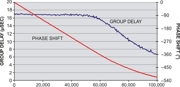

Figure 3. Measured within the passband of DC to 30 kHz, the Bessel filter’s
phase-shift and group-delay characteristics display excellent
uniformity and linearity.
Figure 3 illustrates the filter's phase shift and its group delay, which remains relatively constant at roughly 17 µsec, even for frequencies as high as 40 kHz. Note the linear scale on Figure 3's frequency axis, which clearly illustrates the filter's linear-phase behavior within the passband. The following equation defines group delay as the negative partial derivative of phase shift with respect to frequency:
