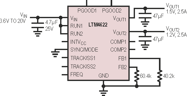

The LTM4622 has a wide input voltage range of 3.6 V to 20 V, and it can be configured to operate down to 3.1 V for operation from a 3.3 V input supply. It regulates two voltages for a compact multi-rail solution, where each output can supply up to 2.5 A (3 A peak) and is capable of precisely regulating 0.6 V to 5.5 V within ±1.5% maximum total DC output voltage error over line, load and temperature. For higher output current up to 5 A, simply tie the outputs for current sharing. The LTM4622 requires only three ceramic capacitors and two resistors to complete a solution occupying less than 1 cm2 single-sided or 0.5 cm2 on a doublesided PCB.
Ultrathin Dual 2.5A or Single 5A μModule Regulator Fits on the Backside of PCBs, Allowing Space on the Topside for Digital ICs
Figure 1. Typical Application: 1.5 V/2.5 A, 1.2 V/2.5 A Dual.

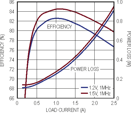

Figure 1 shows the LTM4622 circuit in a typical dual output application, illustrating the compact solution size. Efficiency and power loss for the circuit operating at 12 V input are shown in Figure 2.
Figure 2. Efficiency, Power Loss at 12 V Input (Figure 1 Design).

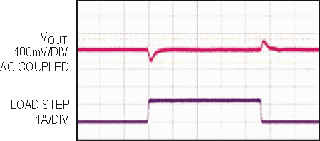

Figure 3. Load Step Response (Figure 1 Design)
[12 V Input, 1.5 V Output, 1.25 A to 2.5 A].

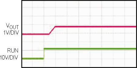

Figures 3 and 4 demonstrate the fast transient and prebias start-up performance for the 1.5 V output rail of the Figure 1 circuit.
Figure 4. 12 VIN, 1.8 VOUT Start-Up into Prebiased Output.

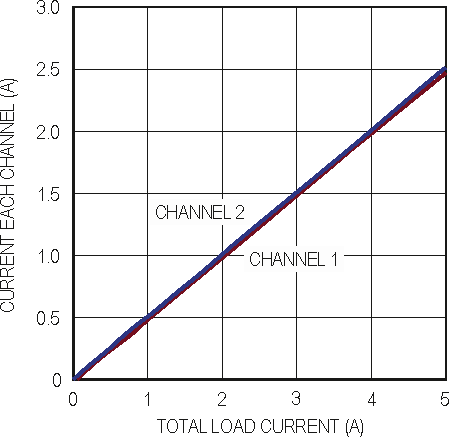

The LTM4622's current mode architecture yields reliable cycle-by-cycle current monitoring, allowing its two outputs to be combined in parallel for load currents up to 5 A.
Figures 5 and 6 demonstrate the thermal and current sharing performance of the LTM4622 when configured for two-phase current sharing, generating a 3.3 V output at 5 A (16.5 W) from a 5 V input.
Figure 6. Accurate Current Sharing Over the Entire Load
Range [VIN = 5 V, VOUT = 3.3 V at 5 A].
