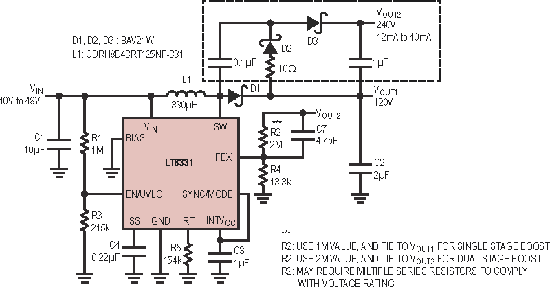

High voltage applications are easily accomplished using a simple boost converter, as shown in Figure 1. This application can output 120 V at 25 mA to 80 mA in a straight boost configuration or 240 V at 12 mA to 40 mA as a two stage boost by adding a few components, as shown inside the dotted line. The load can be taken entirely from VOUT2, or a combination of VOUT1 and VOUT2.
Monolithic Converter Delivers High Output Voltages
Figure 1. 120 V or 240 V Output Boost Converter.

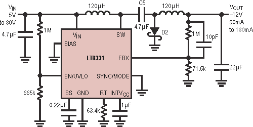

A high voltage negative output rail can easily be attained by configuring the converter as shown in Figure 2. This converter allows full switch voltage utilization to produce a negative output, by adding a capacitor and a diode. A coupling capacitor, C5, adds input to output disconnect during shutdown, similar to a CUK converter.
Figure 2. –120 V Inverting Converter.

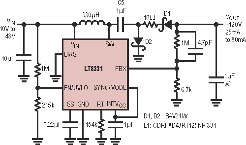

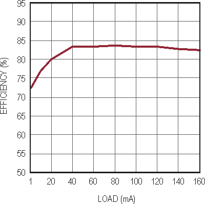

Figure 3 shows a CUK converter using the LT8331, and Figure 4 shows the efficiency curve for this inverter with a 12 V input. Efficiency for this converter peaks at 84%. Burst Mode operation kicks in when the load drops to about 40 mA, which allows the converter to maintain a respectable efficiency level of 73% even with a 1 mA load.
Figure 3. –12 V Output CUK Converter.

Figure 4. Efficiency Curve for Figure 3 (with a 12 V Input).
The LT8331’s 4.5 V to 100 V input range and its 140 V rated switch make it an ideal candidate for SEPIC and CUK converters. Coupling capacitor, C5, breaks the input to output DC path, a desirable characteristic in applications where the output must be disconnected from the input. This has the added benefit of removing the current drawn by the FBX resistor divider. The switch voltage in these converters equals the sum of the input and output voltages.
