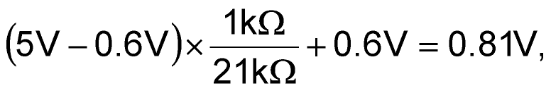

To scan button B0, P1 must be configured as an output and set low. P0 is configured as an input, with the optional internal 20 kΩ pull-up resistance enabled (input pins with switchable pull-up resistors are available with any ATmega microcontroller and with several other MCUs). Thanks to this pull-up resistance, P0 will be at a high level when the button is open. When the switch is closed, the voltage on P0 is approximately:
which will be considered a low logic level.
