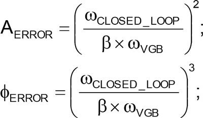

where AV is voltage gain and K1 is a constant. Amplifier A2 provides feedback to amplifier A1. K2 determines the amount of phase-error compensation and has no effect on the forward gain of the composite amplifier. Optimum error cancellation occurs when K1 is equal to K2. The error terms are functions of complex frequency response, according to the following equations:
Figure 3 shows the new configuration, which applies an active feedback network to a two-op-amp configuration. You correct the phase delay through A1 using the active-feedback circuitry comprising A2 and four resistors. The classic two- and three-amplifier instrumentation amplifiers and this proposed three-amplifier topology using active feedback have similar dc CMRRs. However, the circuits’ ac CMRs differ. This difference in performance arises when you apply and sweep a large ac common-mode voltage at the input. These test specs are for a circuit using Analog DevicesAD8603 op amps. The supply voltage is ±2.5 V, the common-mode voltage is 0.001 mV, and the gain is 100. You take error measurements with a 500-Hz input signal.
