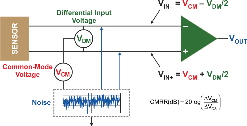

Before delving into the different approaches, let’s first look at what we’re trying to accomplish, using the diagram in Figure 1.
The Evolution of the Instrumentation Amplifier
Figure 1. Block diagram of sensor interface to INA.
The sensor outputs are connected to the INA inputs that amplify the differential voltage. Noise comes from many sources, both radiated and conducted. Typical noise may derive from switching power supplies, motors, and wireless devices. Such noise is reduced by shielding and good PCB layout practices; however, some noise will get through.
Fortunately, most of that noise shows up as an in-phase, common-mode voltage (VCM) superimposed on the differential input sensor voltage (VDM), and a properly designed instrumentation with good common-mode rejection ratio (CMRR) will greatly reduce this voltage to maintain gain accuracy. A minimum CMRR is typically specified at dc, while the ac CMRR performance is documented in performance curves.

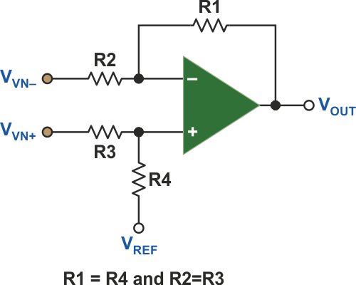

The Discrete Difference Amplifier
If you want to amplify the voltage difference across the sensor output, a simple difference amplifier works, but it has many downsides. In the simple implementation shown in Figure 2, VIN+ is biased to VREF (typically half the supply voltage) for single-supply applications.
Figure 2. Discrete difference amplifier.
Designed to amplify differential voltages, the operational amplifier itself provides good CMRR, but this is overwhelmed by the circuit surrounding it. Any mismatch in the external resistors (including mismatch contributed by any divider network connected to VREF) limits the ability of the op amp to reject common-mode signals, resulting in reduced CMRR. Resistor tolerances are simply not tight enough to maintain a good CMRR that would be expected from an INA. We can see how much the resistor mismatch affects CMRR using the equations below.
The equation below uses a difference amplifier with G = 1 V/V, and TR is the resistor tolerance:
  • If TR = 1%, worst-case dc CMRRDIFF will be 34 dB
  • If TR = 0.1%, worst-case dc CMRRDIFF will be 54 dB
where ‘K’ is the net matching tolerance of R1/R2 to R3/R4, and K can be as high as 4TR (worst case):
The amplifier amplifies the differential voltage at the input, and the gain of the amplifier is:
The problem is that the differential voltage (VIN- and VIN+) includes superimposed noise, and any common-mode voltage that’s not rejected (due to poor CMRR) will be amplified, resulting in an output being corrupted by noise.
This simple approach also has other drawbacks. Typically the input impedance of an operational amplifier is high (MΩ to GΩ range). However, because of the feedback path and reference, the impedance is both reduced and imbalanced, thus loading the sensor and adding to inaccuracies. While this circuit will amplify a small signal sensor, the poor gain accuracy in the presence of noise would not be useful for instrumentation purposes.

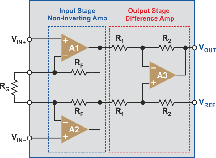

The Three Op-Amp IC Approach
This is a common INA packaged in a single integrated circuit (IC) (Fig. 3). The circuit is divided into two stages: The input stage has two inverting buffer amplifiers, and the output stage is a traditional difference amplifier. The internal resistors used throughout this design are matched to a very close tolerance only possible with trimmed resistor semiconductor designs, resulting in a much higher CMRR.
Figure 3. Three-operational-amplifier IC approach.
The input-stage amplifiers also provide high impedance, which minimizes loading of the sensors. The gain-setting resistor (RG) allows the designer to select any gain within the operating region of the device (typically 1 V/V to 1000 V/V).
The output stage is a traditional difference amplifier. The ratio of internal resistors, R2/R1, sets the gain of the internal difference amplifier, which is typically G = 1 V/V for most instrumentation amplifiers (the overall gain is driven by the amplifier in the first stage). The balanced signal paths from the input to the output yield excellent CMRR.
The design is simple to implement, has a small footprint, and fewer components, leading to lower system costs. The design is also compatible with single-source supplies using the VREF pin. However, even with this design, there are limitations to consider.
Three op-amp INAs achieve high CMRR at dc by matching the on-chip resistors of the difference amplifier, but the feedback architecture can substantially degrade the ac CMRR. In addition, parasitic capacitances can’t be completely matched, causing mismatches and reduced CMRR over frequency. The common-mode voltage input range is limited so that internal nodes don’t saturate. The VREF pin requires a buffer amplifier for optimal performance. Lastly, the temperature coefficient of the external and internal gain resistors aren’t matched, which contributes to a decline in CMRR.
Mathematically, the gain accuracy depends on resistor matching:
where:

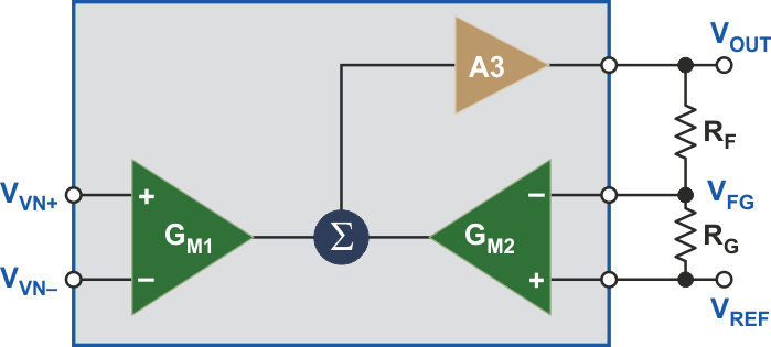

The Indirect Current Feedback Approach
The indirect current feedback (ICF) INA uses a novel voltage-to-current conversion approach (Fig. 4). It’s comprised of two matched transconductance amplifiers, GM1 and GM2, and a high-gain transimpedance amplifier (A3). The design doesn’t rely on balanced resistors, so internally trimmed resistors aren’t required, thereby reducing manufacturing cost. Another advantage is that the external resistors needn’t match any on-chip resistors. Only the RF and RG external resistors temperature coefficients need to match as closely as possible for minimal gain drift.
Figure 4. Indirect current feedback approach.
The dc CMRR is high since amplifier GM1 rejects common-mode signals. And ac CMRR doesn’t decrease significantly with increased frequency. It was mentioned that the three-op-amp approach input range is limited to prevent internal node saturation. With an ICF, the output voltage swing isn’t coupled to the input common-mode voltage, resulting in an expanded range of operation not possible with the three-op-amp architecture.
The second stage (GM2 and A3) differentially amplifies the signal and further rejects common-mode noise on VFG and VREF. Single-supply operation can still be used by applying a bias to VREF.
The ICF INA gain is:
where: VDM is the differential-mode voltage:

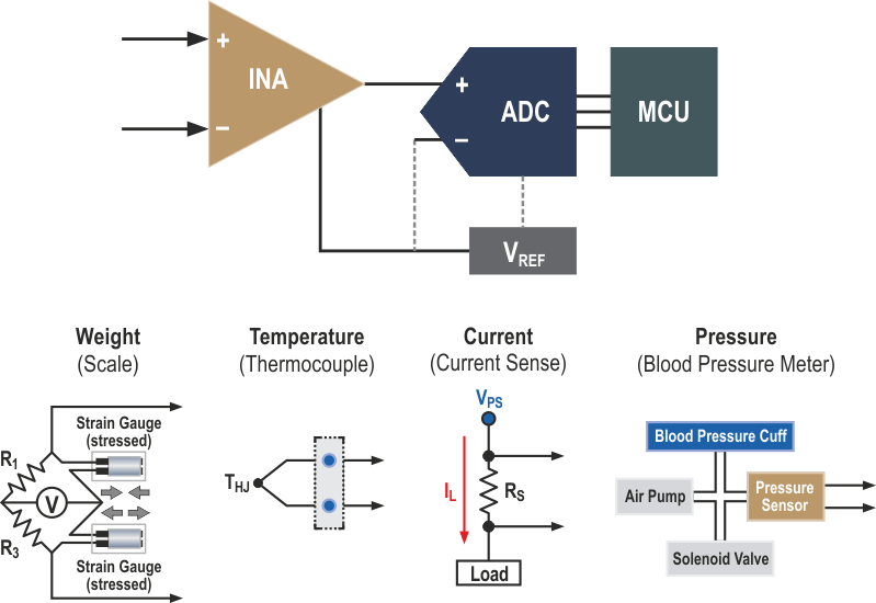

Figure 5 shows a few typical applications for an INA. A variety of sensors are shown that are accurately amplified by an INA feeding a converter and microcontroller.
Figure 5. Shown are examples of a typical circuit using an INA with a sensor.
