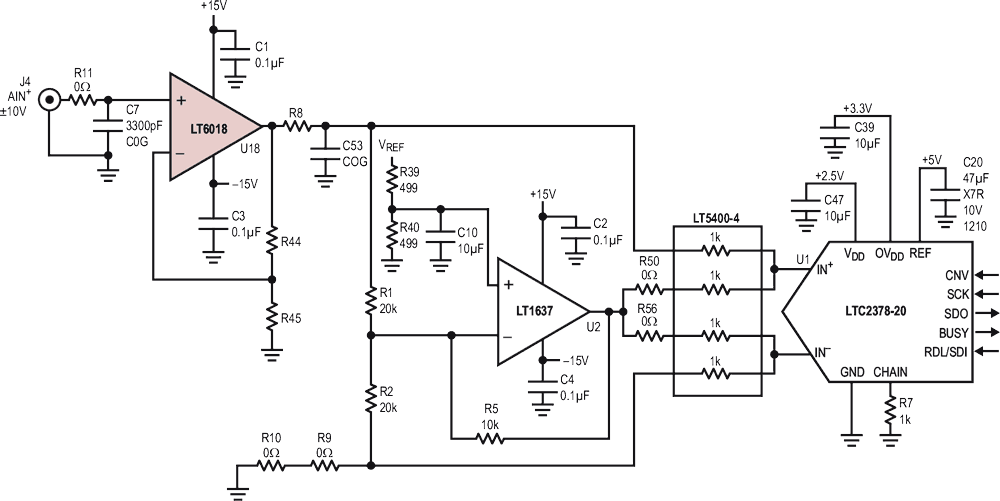

Ultralinear 20-Bit ADC
Figure 1 shows a modification of the DC2135A demonstration circuit, with the LT6018 (replacing the LT1468) driving the LTC2378-20 20-bit SAR ADC. The LTC2378-20 stands out for its unrivaled 2 ppm linearity performance. The best way to create a differential signal while maintaining linearity is by using the precision matched resistors in the LT5400 used on this demo board. A detailed theory of operation for the circuit shown in Figure 1 appears in Design Note 1032 (where the LT1468 drives the LTC2377-20).
Low Noise, Precision Op Amp Drives High Resolution SAR ADCs
Figure 1. DC2135A Demo Board Setup.
To measure the circuit’s linearity, an ultrapure sine wave is fed into the input, and the FFT is calculated at the output. The resulting THD measurement serves as proxy for the circuit’s INL (integral non-linearity) performance. At an ADC sample rate of 800 kHz, we use an input frequency of about 100 Hz (slightly adjusted to ensure coherent sampling, alleviating FFT numerical limitations).
The original demonstration circuit includes an RC lowpass filter directly after the op amp to filter out excess high frequency noise. The LT6018’s noise density remains relatively low even at high frequencies, so removing this filter negligibly affects total noise. Without the filter, linearity (as measured by THD) improves markedly, since the single-ended-to-differential conversion is now entirely governed by the precisely matched resistors in the LT5400, uncorrupted by any poorly matched discrete components.
The LT6018’s low noise density makes it suitable for circuits that require gain. Configured in a gain of 10, the signal strength increases by 20 dB while the SNR degrades by 2 dB relative to full scale. If the input signals are small, this arrangement improves effective signal-to-noise ratio by 18 dB. As expected, linearity is reduced by the same amount as the amplifier loop gain, or about 20 dB.
The results are summarized in Table 1.
Figure 1. LT6018 Driving LTC2378-20 SNR and
THD Results

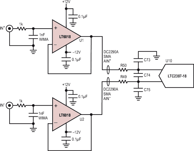

The LTC2387-18 is an 18-Bit SAR ADC that can sample up to 15 Msps. At this sample rate, the ADC’s internal sampling capacitor is connected to the amplifier output for less than 30 ns (the “acquisition time”). During that time, the amplifier (and filter) circuit must recover from charge kickback and replenish the charge of the sample capacitor, so the ADC can measure the correct input voltage at the next conversion cycle. Careful optimization of the amplifier and filter network is in order.
In Figure 2, two LT6018s are configured as unity-gain followers, and connected to the LTC2387-18 demo board, which has provisions for filter resistors and capacitors at the ADC input.
Figure 2. The LT6018 Driving the LTC2387-18 Using the DC2290A-A Demo Board.
Table 2 shows the SNR and THD results, measured for a 1.008 kHz pure sine wave at the input, and the ADC sampling at a coherent 14.680 Msps. The first table entry shows results with the LT6200 amplifier, a very high speed, low noise op amp. The filter configuration is the demo board default bandwidth of about 200 MHz. This allows full settling of the ADC charge kickback, which results in excellent THD of –120 dB. However, SNR is 2 dB below the 96 dB capability of the ADC.
Figure 2. LT6018 Driving LTC2387-18 SNR and THD Results
Amplifier R49 = R50
(Ω)
C73 = C75 C74 SNR
(dB)
THD
(dB)
LT6200 10 82 pF Open 94.2 –120
LT6018 10 82 pF Open 90.3 –72.9
LT6018 25 1 nF Open 94.5 –93.7
LT6018 25 1 nF 1 nF 96.0 –96.1
LT6018 13.7 1.8nF 1.8 nF 95.9 –101.1
The LT6018 has lower bandwidth than the LT6200, but much better DC accuracy (offset and drift). However, plugging the LT6018 into the same configuration as the LT6200 significantly degrades SNR and THD. SNR is degraded because amplifier noise density can be higher above its bandwidth than below, and this noise, if not filtered, will alias into the ADC. THD is degraded because the slower amplifier – when hit with the full ADC charge kickback – does not properly settle and leaves non-linear residues for the ADC to digitize.
We can filter the wideband amplifier noise by increasing the value of the resistors and capacitors, and by including a differential capacitor between the two ADC inputs. Doing so improves the SNR all the way to the theoretical maximum of 96 dB for this ADC, which means that integrated amplifier noise has become negligible. Furthermore, by skewing the filter configuration toward smaller series resistors and larger capacitors, the initial effect of the charge kickback is attenuated, resulting in improved THD performance, well below –100 dB.
