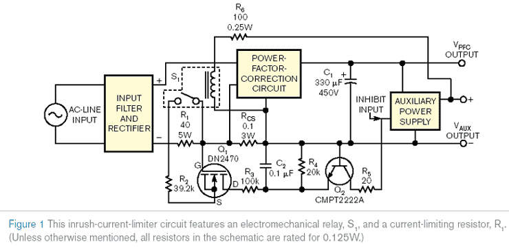

Practical version of a PFC circuit
Figure 1 shows a practical version of a PFC circuit, which employs a switched-resistor inrush-current limiter. The inrush-current-sensing subcircuit comprises a wirewound resistor, R1, and a parallel depletion-mode MOSFET, Q1, which connects to resistor R2 as a current source that drives resistors R3 and R4. Over a wide range of the voltage drop across R1, from a few hundred volts to a few volts, this circuit generates a small constant current that suppresses operation of the auxiliary power supply and prevents interference with the inrush-current-limiting process.
When the inrush current decreases sufficiently, the voltage drop across R1 becomes insufficient to keep Q1 in operation as a current source. Q1’s current extinguishes, allowing the auxiliary power supply to turn on and start the power supply, by activating relay S1, whose contacts short-circuit R1. R2’s value determines the current necessary to hold the auxiliary power supply in a disabled mode, allowing PFC-rail capacitor C1 to charge fully.
A 12 V electromechanical relay, such as Omron’s G2RL-1, provides low-resistance contacts to bypass R1. As an alternative, an optically isolated solid-state relay, such as the Carlo Gavazzi RP1A48D5, with a MOSFET or an SCR (silicon-controlled-rectifier) output device can replace S1, provided that the voltage drop across the output device introduces no substantial power loss.

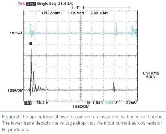

Charging process's waveform as the voltage drop across R1
Figure 2 depicts the charging process’s waveform as the voltage drop across R1. The exponential envelope and its subcycles represent components of the inrush process; R3 and C2 filter out the subcycles and produce a decreasing exponential voltage waveform across R4, holding Q2 on for the duration of the inrush process. Q2 suppresses the auxiliary power supply’s operation by pulling its disable input low. At a few volts across R1, Q1 stops generating constant current and shuts down Q2 to enable the auxiliary power supply. Thus, the entire power supply waits until the inrush current attains a safe value that R2 sets. The power supply starts immediately after relay S1 trips and shorts out inrush resistor R1. The remainder of Figure 1 comprises a conventional PFC but may also represent a part of any other power-supply configuration.

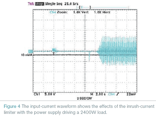

Start-up of a 2.4-kW power supply with the inrush-current limiter and a slow-start circuit
2400 W power-supply start-up. Its inrush current is intentionally approximately 5 A
Trace 1 in Figure 3 depicts the start-up of a 2.4-kW power supply with the inrush-current limiter and a slow-start circuit, which allows the separation of the inrush and the start-up processes. The inrush-current value is 5 A, a relatively low value for a 2.4-kW power level. Trace 4 shows the input current measured with a current probe. Figure 4 depicts a 2400 W power-supply start-up. Its inrush current is intentionally approximately 5 A, which is far less than its operating current of approximately 14 A.
