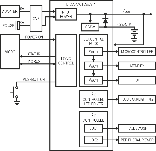

Battery, USB, Wall and High Voltage Input Sources
The LTC3577/LTC3577-1 is designed to direct power from two power supply inputs and/or a Li-Ion/Polymer battery. The VBUS input has selectable input current limit control, designed to deliver 100 mA or 500 mA for USB applications, or 1 A for higher power applications. A high power voltage source such as a 5 V supply can be connected via an externally controlled FET. The voltage control (VC) pin can be used to regulate the output of a high voltage buck, such as the LT3480, LT3563 or LT3505 at a voltage slightly above the battery for optimal battery charger efficiency.
Figure 1 shows a system block diagram of the LTC3577/ LTC3577-1. An overvoltage protection circuit enables one or both of the input supplies to be protected against high voltage surges. The LTC3577/LTC3577-1 can provide power from a 4.2 V/4.1 V Li-Ion/Polymer battery when no other power is available or when the VBUS input current limit has been exceeded.
Portable Device Power Distribution Block Diagram Featuring the LTC3577/LTC3577-1.
Figure 1. Portable Device Power Distribution Block Diagram Featuring the LTC3577/LTC3577-1.

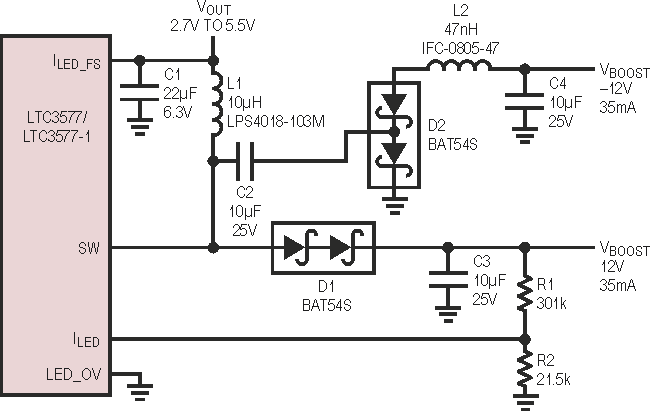

The LTC3577/LTC3577-1 LED boost driver can be used to drive up to 10 series white LEDs at up to 25 mA or be configured as a constant voltage boost converter. As a LED driver, the current is controlled by a 6-bit, 60 dB logarithmic DAC, which can be further reduced via internal PWM control. The LED current smoothly ramps up and down at one of four different rates. Overvoltage protection prevents the internal power transistor from damage if an open circuit fault occurs. Alternatively, the LED boost driver can be configured as a fixed voltage boost, providing up to 0.75 W at 36 V.
Dual Polarity Boost Converter.
Figure 2. Dual Polarity Boost Converter.
Many circuits require a dual polarity voltage to bias op amps or other analog devices. A simple charge pump circuit, as shown in Figure 2, can be added to the boost converter switch node to provide a dual polarity supply. Two forward diodes are used to account for the two diode voltage drops in the inverting charge pump circuit and provide the best cross-regulation. For circuits where cross-regulation is not important, or with relatively light negative loads, using a single forward diode for the boost circuit provides the best efficiency.
