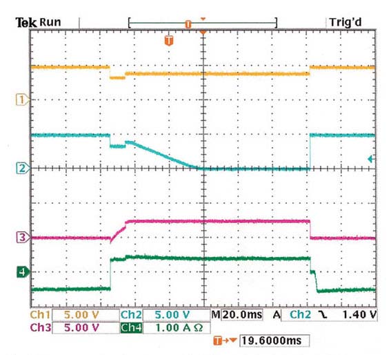

Figure 2. This scope screen shows the performance of the POK-based circuit as the load is switched from dc power to battery and back to dc power. Channel 1 is the voltage across the load. Channel 2 is the dc supply voltage. Channel 3 is the POK output, and Channel 4 is the battery current.
When Vdc In is removed, POK becomes a high-impedance node, and battery current flows through the body diode of Q3. The load voltage is Vbatt – Vdiode. Because Q5’s gate is biased at the battery voltage, Q5 conducts until POK reaches a voltage level sufficient to service the load by turning on Q4 and Q3. Figure 2 shows the circuit’s response (with battery installed) when Vdc In is applied and removed.

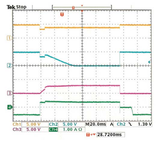

A modified circuit is suitable for battery-charging ICs such as the MAX1507, which does not provide a POK output (Fig. 3). The comparator (U3) supplies a POK output by comparing Vdc In to the battery voltage. This modified circuit’s response is very similar to that of the original circuit (Fig. 4).
Battery-Charger Load Switch Approximates An Ideal Diode
Figure 4. The circuit in Figure 3 delivers similar performance to that of the original POK-based circuit.
