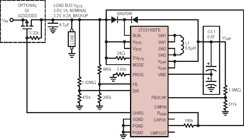

The LTC®3110 bidirectional buck-boost DC/DC regulator charges and balances a supercapacitor when a bus voltage is present (for example 3.3 V) and discharges the supercapacitor into the load when the bus fails. The LTC3110 maintains the bus’s nominal level (3.3 V in the example in Figure 1) even if the supercapacitor voltage is above or below the nominal bus voltage. Supporting the load this way allows data backup and retention during a power interruption – important in a wide variety of industrial and automotive applications.
Bidirectional DC/DC Regulator and Supercapacitor Charger
Figure 1. LTC3110 Application, VSYS = 3.3 V, VCAP = 5.0 V.

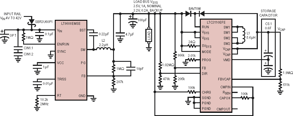

Figure 2 shows a low profile energy storage solution for data backup or wireless data transmission in situations where the input voltage changes in an extremely wide range from 4 V to 40 V, with possible input voltage interruption.
Figure 2. LTC3110, High Voltage Application, VIN = 4 V to 40 V, VSYS = 3.3 V, VCAP = 5.0 V.
This solution uses two converters to produce a complete industrial/automotive application. The converter, based on the LTC3110 supercapacitor charger (SCCH), charges the storage capacitor when the input voltage is present and provides a regulated system output during power interruption. Under normal operating conditions, when a 4 V to 40 V input supply is present, sensitive electronic loads and the LTC3110 are supported by a step-down converter (SDC) based on the LT8608.
The LT8608 is a low quiescent current, high efficiency, highly integrated synchronous buck converter featuring a wide input voltage range extending from 3 V to 42 V. Its 42 V upper limit minimizes the volume required for system protection circuitry, practically eliminating the need for traditional transient voltage suppressor diodes (TVS). The SDC maintains the system voltage within 3.3 V bus rail limits.
If the input voltage is disconnected, the SCCH takes over, powering the regulated 3.3 V rail. The LT8608 supplies 3.5 V to the system bus under normal circumstances; the LTC3110 supplies 3.2 V when it registers a power failure and supports the load. These supply voltages are well within the recommended limits for 3.3 V logic power supplies. The /CHRG flag can be used to alert digital systems to disconnect non-essential loads and begin data backup or wireless transmission.

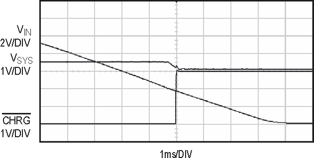

Figure 3 shows the beginning of the switchover process; with the input voltage disconnected, the SDC turns off while the SCCH is turning on.
Figure 3. Switchover [VSYS Load Voltage, VIN Input Voltage, /CHRG Flag Status].
